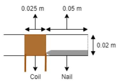

The image you supplied above in post#4 seems to be missing some information. If the given dimensions are correct and it was carefully and neatly wound, the coil has about 600 turns in 14 to 15 layers. The coil inductance is affected by its physical dimensions and the number of turns.
If you can supply the outer dimension of the winding and the size and material of the projectile, we can show you how to approximate the coil inductance. Since the inductance, resistance, and capacitance all affect the peak current and the time to discharge, it will be easier to understand the whole problem.

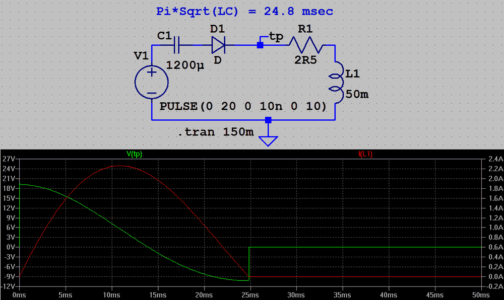

π * Sqrt( 1200 uF * 50 mH ) = 24.335 ms

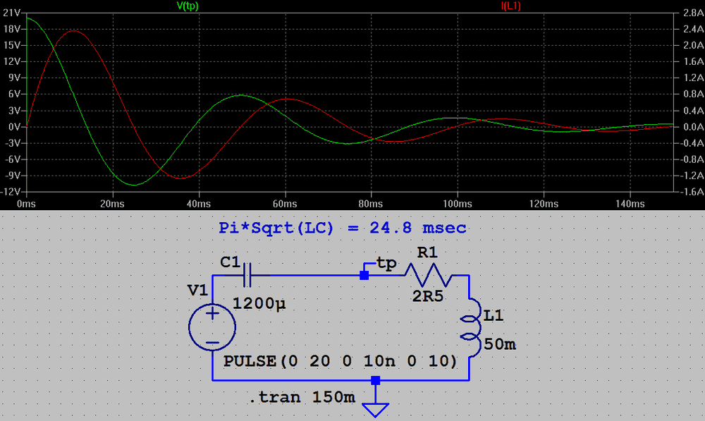

To simulate a capacitor, charged to 20 volts, then connected to the coil, the capacitor is driven with a 20 volt step. Notice that, as predicted with these values, the first half cycle of current (red) lasts for about 25 msec. Notice also the decaying sine and cosine waves of current (greenred) and voltage (redgreen) in the circuit.
In the second circuit I have added a diode that blocks the second half cycle, so it produces a single magnetic pulse peaking at 2.25 amp, lasting 25 msec. ( It returns the unused energy to the capacitor).

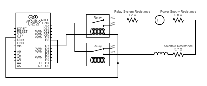

I have encountered a somewhat minute concern with my setup.
Here's the current circuit for anyone who's curious:
Here's the code I'm running on the arduino:

Do you have flyback diodes across the relay coils ?
A higher voltage will draw a higher current from the 19 V supply and batteries.
Measure your battery voltages.
Unfortunately we need to know the inductance of the coil to model the situation.
The coil's inner diameter is 2.5cm and the outer diameter is 4.5cm. It is 60m of 24AWG copper wire. The length of the coil is 6cm. Is this enough to estimate inductance?
I also do not have flyback diodes. The circuit just disconnects after the discharge time.
I am not talking about the gun coil. You really need a power diode across the solenoid coil. When the output D7 or D8 turns off the current to the relay coil, there will be a voltage spike produced by the relay coil that will damage the D7 or D8 output circuit.
https://en.wikipedia.org/wiki/Flyback_diode

Sorry for taking so much of everyone's time, but I think I have a final concern/question.
For my solenoid, it turns on because I close the circuit using a relay. But then, I open the circuit to turn it off. Does this still mean I have pullback? I'm aware that a solenoid in a capacitor circuit will have a current flowing in the opposite direction to oppose the magnetic flux when it turns off. But is this still possible in a circuit that's just open?
My circuit diagram is still above. Maybe I'm missing some technicality. But surely the solenoid isn't perfect right? What are some energy losses or inefficiencies? Maybe it is the pullback?
The current in an inductor continues to flow in the same direction when you disconnect it. It is the voltage that reverses, causing the “flyback” voltage spike that can damage semiconductors.
With metal contacts in a relay, a high reverse voltage arc will form as the contacts separate. That negative voltage makes di/dt = V / L very high so the current flow rapidly reduces.
The energy that was stored in the inductor's magnetic field appears as heat in the arc. E = ½·L·i²
  • #31
Ah, so if I'm understanding correctly, the solenoid still has a pullback affect on the projectile, but the energy from that pullback is transferred to heat energy in the relay module?
If that were the case, it explains why the relay modules heat up during the experiment.
  • #32
The two relays heat due to the resistance of the coil. One relay is also heated by the arc between the opening contacts. If you take the cover of that relay and operate it in the dark, you should see that arc.
A "flyback" or "freewheeling" diode across the gun coil would drop a low reverse voltage, (≈1 volt), so the current continues to flow for a longer time, and the projectile will be pulled back.
The arc at the opening relay contacts can be timed to rapidly kill the magnetic field as the projectile enters the centre of the coil. That greatly reduces pull back of the projectile.
A capacitor discharge through a diode to the gun coil produces a single half sine wave pulse, so it does not cause pull back of the projectile, and it does not produce a flyback pulse that might destroy a semiconductor switch.
Likes lekh2003
  • #33
Thank you very much for the explanation. It makes sense.
The fact that a capacitor would have been a better choice is also useful information. I can point out that it exists as a weakness of my experimental setup.
