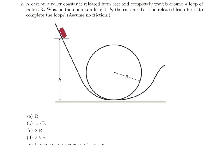

Conservation of Energy (Potential + Kinetic = Potential + Kinetic)
At the start of the ramp, potential energy is mgh (gravitational potential) and kinetic is 0, since it's not moving.
At the bottom of the loop, potential energy is 0 (I consider the bottom to be the zero of gravitational potential to make things easy), and kinetic is 0.5 mv^2.
The ms cancel to leave me with 2gh = v^2, but that's as far as I got...
