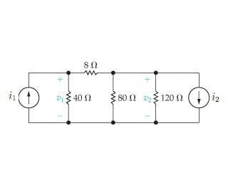

Use the node-voltage method to find v1 in the circuit(Figure 1) if i1 = 6.2A and i2 = 1.5A .
Use the node-voltage method to find v2 in the circuit.

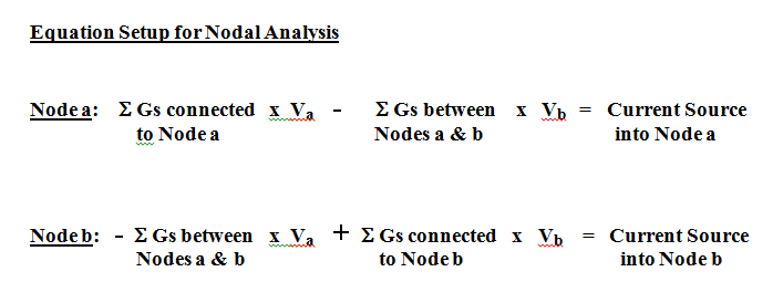

G = 1/R
Top side going from left to right, I assigned each node as 1, 3, then 2 (because of the way v_2 is assigned).
For Node 1, I had:
(v_1)/40 - (v_3)/8 = 6.2
Node 3:
-(v_1)/8 + (v_3)/80 = 0
Node 2:
(v_2)/120 = -1.5
Solving, I got v_1 = -5.06 V and v_2 = -180 V. These are wrong (obviously). Any assistance would be appreciated.
