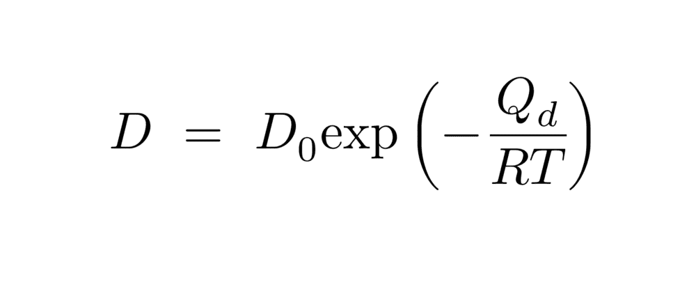

For example sake, here's the diffusion coefficient formula for solids (Callister, 2010):
I don't a have a clue on what it means. I can explain each term independently, I know its application, but I don't know their relation, and this happens in almost every formula presented to me. No one actually bothered explaining this to me, and I just realized now that I pass through formulas and never actually understand them.

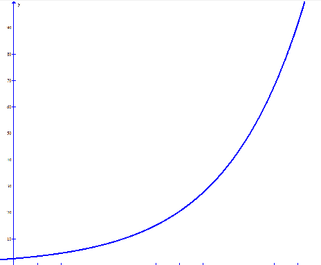

The first thing you do is grasp the main information: In your example you have ##D=D_0e^\alpha##, which means that ##D## depends exponentially on ##\alpha##. Assuming ##D_0> 0## this automatically means a graph like this:
One way to understand is to use a graphic program and play with the constants ##D_0## and ##\alpha## to see how the curve changes. Now ##\alpha## is the next part of the equation. What is here the main information? ##Q_d## and ##R## are constants, so we have basically ##\alpha \sim \dfrac{1}{T}##.

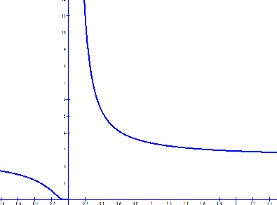

This changes our initial graph, since we now have ##D \sim e^{1/T}##, a quantity which quickly (exponentially) decreases with (linearly) increasing temperature:
This reminds of a radioactive decay over time.
Conclusion: The diffusion coefficient decreases exponentially with increasing temperature. The specific curves depend on the gas involved.

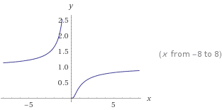

Your equation is more complicated because of the ##1/T##. Assuming ##T## is the important variable, and ##Q_d/R## is some constant of the system in question, ##D## has starts at a zero value at absolute zero (##T=0 \ K##) and increases towards a hypothetical maximum of ##D_0## as ##T \rightarrow \infty##. I.e. you have an equation of the form:
##D = D_0 \exp(-\frac{\alpha}{T})##
Note that I've assumed that ##\alpha## is positive here.
This looks like the right-hand side here, with ##y = D## and ##x = T##:
Note that ##D## will increase fairly rapidly to something close to ##D_0## and then flatten out.
