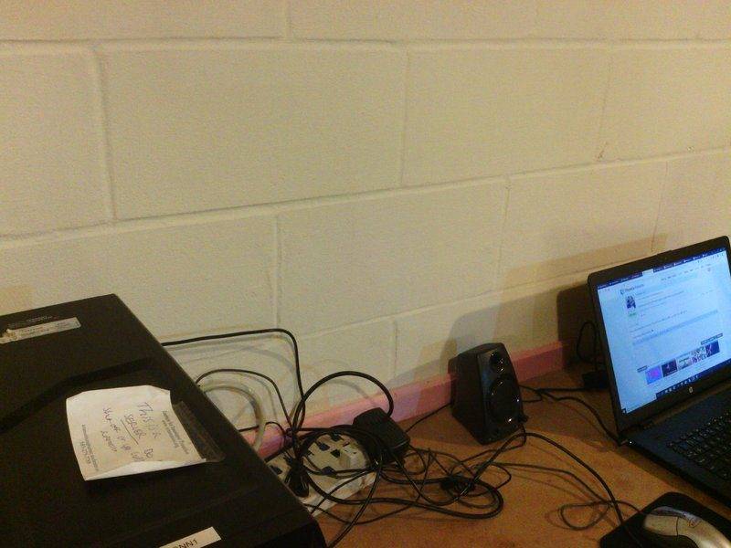

Does anyone know how to wall mount a shelf rack (similar to a Truss shelf rack) to a concrete basement wall and hook computer supplies (like speakers, monitors/displays) on them while making the shelf rack detachable at the same time?

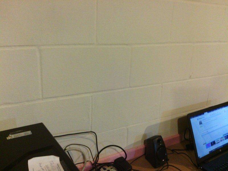

Well, i have a desk in the basement of the townhouse and I want to install the shelf racks on top only so that I can hook computer peripherals (like speakers, monitors and displays, whatever) on them for cable management and stuff. It's kind of like a gaming/workstation area. I have 3 total desktop computers. They're all refurbished. I'm just trying to update my workstation/gaming area .
Can you post a photo of the area to give us a better feel for space and equipment?
I'd make a "French Cleat" and fasten it to the wall with Tapcon(or similar) concrete screws. Then hang the shelf from the cleat.http://www.popularmechanics.com/home/how-to-plans/how-to/g2340/how-to-build-a-french-cleat-shelf/http://www.tapcon.com/products/concrete-screw-anchors/original-blue-tapcon
