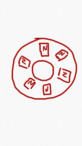

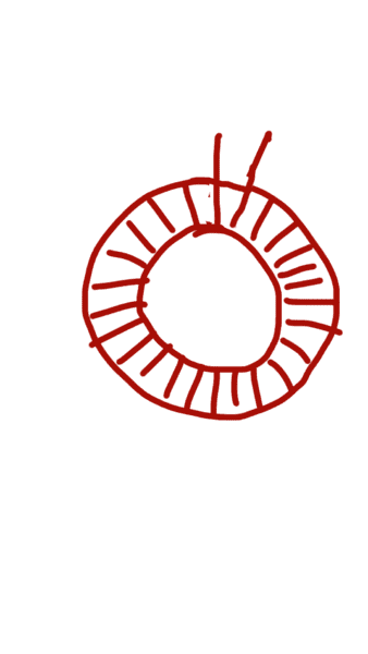

I want to make a dc generator and not sure my design will work. I will wind the coil on a donut shape disk and put 6 rectangular magnets on a disk rotor with North Pole face the coil. Please see attached pictures. Will this design works or have problems? Can I have one continuous coil or I should break it into 6 coils(1 for each magnet)? Also, if the rotor rpm is 3600, what gauge wire I should use for the coil so it won’t burn?

If you rotate the magnets you will need to make an alternator and rectify the AC produced in the fixed coils. You will need to reverse each magnet so the magnetic flux through the coils keeps changing.
If you fix the magnet(s) and rotate the coils, you will need a commutator to rectify the voltage generated by the coils as they pass through the magnetic field.
The size of the wire is decided by the current your load will draw.
The number of turns on your coil(s) will decide the voltage you generate.
The voltage is also proportional to RPM and strength of the magnets.

I am rotating the rotor which has the magnets. Why do we need to reverse the magnets? I see this one below works without reversing. What is wrong with my winding orientation? Also, at 3600 rpm, what gauge wire can produce a desired 36 volts? Is there a formula? Thanks
If the magnets all point the same way the flux will be constant. Alternating poles produce the greatest change in flux as it rotates. Its changing flux that produces the voltage.

The flat coil you show wound on a donut shaped disk will have coil turns that are not cut by the magnetic field. The magnetic lines must go one way through the area of the coil, then the other way, so the turn faces must pass alternate N and S poles of the magnet as it turns.
Again, with the right geometry the voltage can be doubled by, 1; using twice as many turns, 2; using a magnet that is twice as strong, or; 3; by turning the generator at twice the speed. What will you power with your generator? How much current will it use?

I planned to build something like the video showing. I will sandwich the coil in the middle so the magnets field will cut through all coil turn. I want to use solar to power a small 3600 rpm motor (https://www.amazon.com/dp/B0745YDSJS/?tag=pfamazon01-20) which will run my dc generator. The generator output will go into a 36v grid tie inverter which will provide electricity for the house. I want get maximum power out of my generator. I wonder how many Amps my generator can produce at 3600 rpm without burning up and what gauge wire I should use? Thanks
