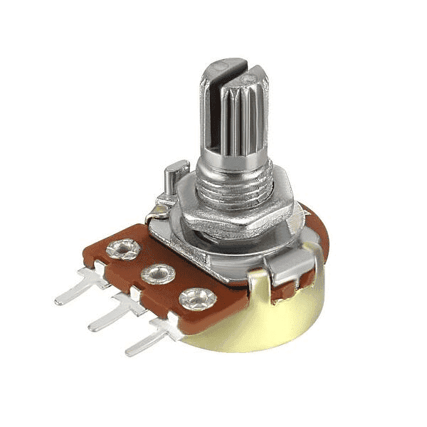

Does your component have 3 leads like this?

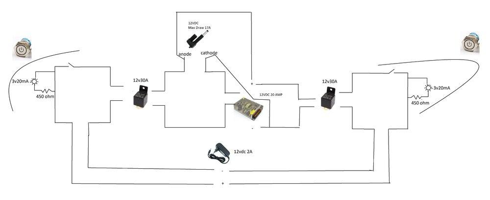

please see my attached circuit diagram. i look forward to your criticism. this circuit has 2 push buttons for moving the motor in opposite directions by having opposing polarity from one button circuit to the other

You're missing the point. Using a switch instead of a contactor or a breaker could result in a very short lifetime for the switch or even a fire.

You use the low-power switches to turn on the contactor. It's done all the time.

Sorry, I'm not able to understand your drawing yet. And be careful with direction/polarity reversals -- you need to ensure that both directions can't be on at the same time.

My diagram is incorrect. This would short circuit my power supply everytime current is run to the motor. Thanks for spotting this. I think I'll have to look at some way to switch both poles on and off. Maybe something like a dpst relay could work?

Yes, and you can probably find a contactor that has the configuration you want (DP3T, Break-Before-Make).

So now you have introduced another requirement: switching from forward to reverse. How are you going to deal with the back EMF when you do that?

He'd need to include transorbs, I would think. Unless he can find a contactor that already has them built-in.
