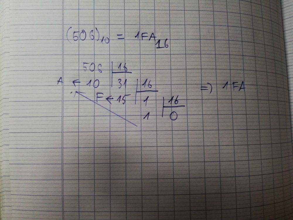

Forget the program for a moment. Say I give you a a decimal number (506)10. How do you convert this to hexadecimal?
Likes hapypy_09
I think I will divide it by 16 until the right part is zero then stop.
- Like this:
Likes Merlin3189, WWGD and Wrichik Basu

@hapypy_09, here's an example showing how to convert a decimal number to hexadecimal, with N = 4032. At each step I divide by 16, keeping track of both the quotient and the remainder.
Step 1: 4032/16 = 252 (quotient), and 0 (remainder)
Step 2: 252/16 = 15 (quotient) and 12 (remainder)
Step 3: 15/16 = 0 (quotient), and 15 (remainder)
The process terminates when the quotient becomes 0. The hex representation consists of the remainders, as hex digits, in reverse order. At most, there will be 8 steps for a 32-bit integer.
So the hex representation of 403210 is FC016, usually written as 0xFC0.
The division I did above was integer division - no fractional part.
To get the remainder, all you need to do is to look at the lowest 4 bits, which you can do by anding the number with 0xF, like this: andi $t0, $a0, 0xF.
You can do integer division of a positive number by shifting right by 4 bits; for example as srl $a0, $a0, 4.
To convert from a decimal number in the range of 0 through 15 to a hex digit 0, 1, 2, ..., 9, A, B, C, D, E, F, use a lookup table, a byte array of these characters.
One tricky part to this problem is putting the hex digit character into a string in reverse order.
Likes hapypy_09, berkeman and sysprog
