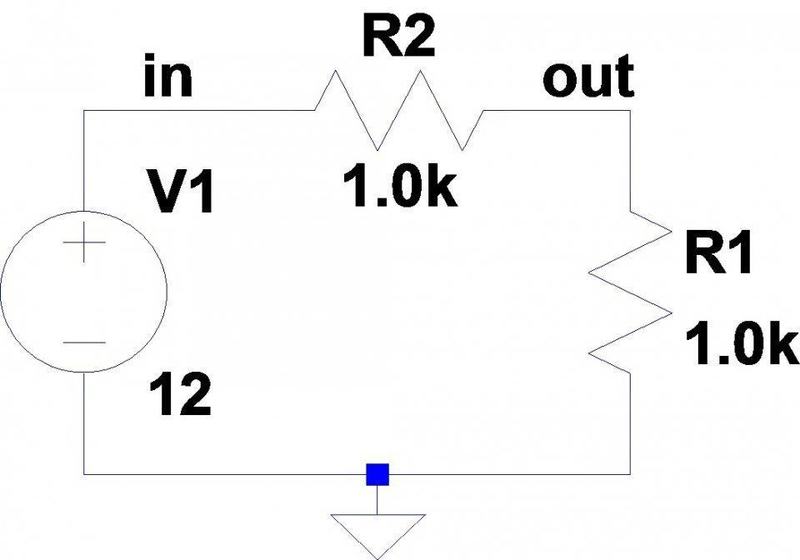

OK - I will do you a favor - here is my answer:
Claude: Vbe is not applied externally.
For designing a BJT amplifier stage the classical procedure is to „open“ the transistor with an externally applied voltage of app. 0.65 volts.
Please note that it is not necessary to teach me that nobody uses for this purpose a battery or something like that. Everybody knows how this accomplished (even me).
Claude: Take a 12 volt battery, with a pair of 1.0 kohm resistors wired in series forming a divider. A switch is thrown and the circuit is energized.
The steady state current is 6.0 mA, and 6.0 volts is dropped across each resistor. Is this agreeable?
Do you really expect an anwser?
Claude: So examine the second resistor, connected to ground, whose voltage is 6.0 volts, one end at 6.0V, the other end ground. With me so far?
Does this 6.0 volts "drive" the 6.0 mA current in same resistor?
Why such an absurd question? Has anybody claimed so?
Claude: The voltage drop, 6.0 volts, across the 2nd resistor cannot be "driving" the 6.0 mA current in the same resistor. If you disagree, please explain.
Using your logic, every current is controlled by a voltage, so therefore there is no such thing as a current controlled device.
You are fighting against windmills. My only statement was „no current without a driving voltage“.
I ask myself: Why are you twisting the meaning of words ?
Regarding „ELI the ICE man“ and your simulation results - based on an arbritary RC circuit - there are two possibilities:
1.) If you are referring to the steady-state sinusoidal change of electric quantities the observable phase differences cannot say anything about cause and effect resp. the question „what comes first“. I hope you do not need further explanation.
2.) If you refer to the behaviour immediately after t=0 (your first graph in post#22) the result is not very surprising: Connecting a voltage source to a cap, the current hardly can be in advance to the voltage and vice versa. What do you want to proove with this simulation?
More than that, the rule of „ELI...“ does not apply at all (the rule is based on phasor representations and requires sinusoidal signals - hence, steady-state).
Summary: All your simulations and the whole „ELI..“ story is meaningless and does not proove anything.

Does the 6 mA current in R1 determine the 6.0 volts across R1, vice-versa, or is it a circular relation? I controls V, V controls I, or circular? What is your answer? No point discussing the bjt, because this question is at the root of the issue. BR.
Claude

I say the BJT is voltage controlled and am then told by Claude that is a Myth, that Ic is determined by Ie (whatever that means). He then can produce no math or references that support his conjecture, and in fact posts papers that say quite the opposite.
Is the following true for a BJT in the active region (actually, I know it is):
Ie = Ies (exp(Vbe/Vt) -1)
Claude's voltage divider question is only another obfuscation designed to lend credence to his unscientific, unsupportable position that base current is automagically sucked out of the input circuit because Emitter current started flowing and, because of that, the base voltage then increases.
