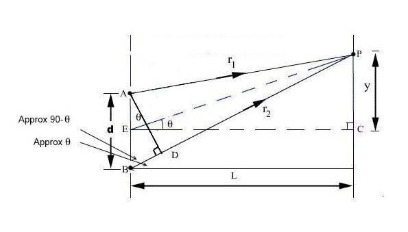

How we know that these angles are equal ?

are these alternate interior angle or exterior angle? is it just because of mathematical rule of geometry or what makes these angle equal?
They are not the same ... the diagram is showing you an approximation.
If L >> d, then the rays AP EP and BP are almost sort of parallel. Now do the geometry.

I was making a version of your diagram when Simon beat me to it..

When L >> d, then AP EP and BP are parallel. What is the reasoning behind this result ? Can it be proven mathematically that the three lines are almost parallel under the approximation L >> d ?
Say the lines have started at A and B and they meet each other at P. L is the distance from the starting point at which they meet. If distance between the lines d is negligible compared to L, they can be treated as two parallel lines. For two actual parallel lines, the distance between them is negligible compared to the distance at which they meet, which is infinity. Hence, their slopes are equal. So, here, the two lines with very small d(in mm) and very large L (in meters) can be approximated as two parallel lines. Their slopes will be almost equal.

Why ? This is what I asked in the previous post :smile: . Could you prove it mathematically ?

For the lines with d<<L, the meeting distance L is very high compared to their separation d. For actual parallel lines, the meeting distance is infinity which means it is very very large compared to their separation. So, the lines with d<<L can be practically treated as parallel lines.
Mathematically speaking, their slopes are almost equal. Draw a horizontal line from A and let it cut the screen at point M. If you calculate the slopes of AP and BP, you'll get slope of AP=PM/AM
and slope of BP=(PM+d)/AM. Let's say AM=1m, PM=1m and d=1mm. So, PM≈PM+d. If PM is small, say 10mm, PM/AM≈(PM+d)/AM since AM is in meters and PM and d are in a few mm i.e. 10mm/1m≈11mm/1m. In both the cases, the slopes are almost equal.

From the diagram in the opening post, the gradient of the lines AP and BP are
$$g_{AP}=\frac{y-d/2}{L} = \frac{y}{L}-\frac{d}{2L}$$
$$g_{BP}=\frac{y+d/2}{L}=\frac{y}{L}+\frac{d}{2L}$$
In the limit ##d\ll L##, the second term in each expression for the gradient goes to zero, and we see that the two gradients are equal. Therefore, the lines are parallel.
