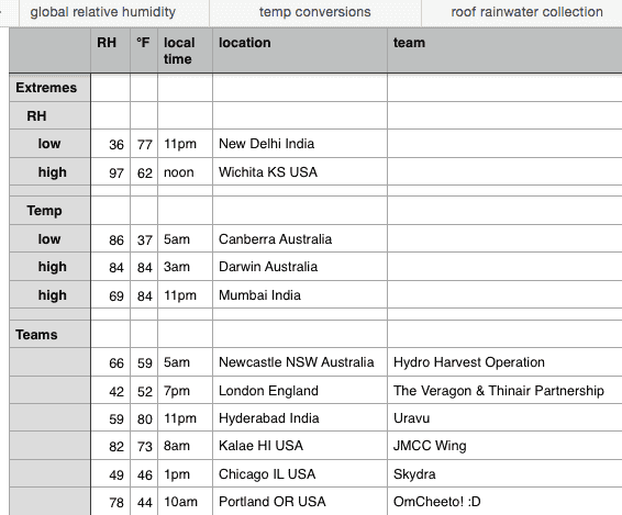

I collected data points for 32 cities yesterday: city name, relative humidity, time, date, and temperature.
hmmmm...
As I said, this may take some time to analyze...
Here are 11 of my data point collection sites:

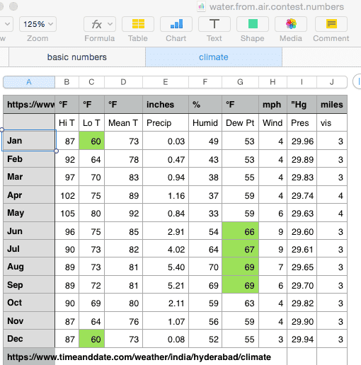

Well, right off the bat this morning, I picked probably the worst city for my device: Hyderabad, Telangana, India
Optimal dew point vs minimal seasonal temperatures are simply too close together for my idea to work there, IMHO.
