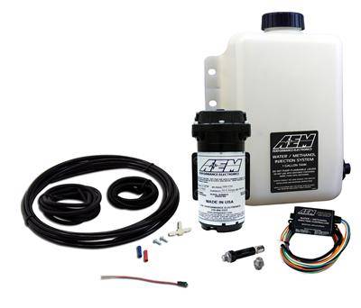

Have you considered trying a water/methanol injection kit?
http://en.wikipedia.org/wiki/Water_injection_(engines )
http://www.summitracing.com/parts/AVM-30-3000/
Would this be against the rules? Although it's not in the tank, methanol would probably count as fuel.
Could be, I didn't bother taking a look at the rules. Still, he might be able to run pure distilled water to cool the intake charge and possibly get a little more "oomph" out of the engine by running more advanced timing. Water injection usually functions as an intercooler application for roots-type blowers, but it does have the advantage of increasing heat absorption in the fuel mixture.

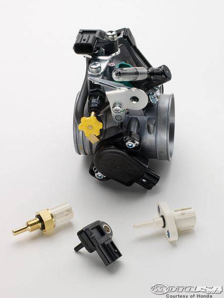

Mounting the injectors at the top of the intake bell uses the vapourization of the fuel to cool the incoming air and increase the density.
The bike uses a throttle body with the injector built in. We can move the whole throttle body slightly, but because of rules we can't change the injector type.

If we did run a water/methanol injector. How much fluid do they normally consume?
  • #35
There's a lot of info on http://www.rbracing-rsr.com/waterinjection.html" and a calculator at the bottom. They say that the coolant to Fuel Ratio (Based on mass not volume) should be in the 12.5% to 25% range.
You can use water alone if methanol is illegal. IIRC, it's less efficient than the 50/50 mix but it still does the job.
