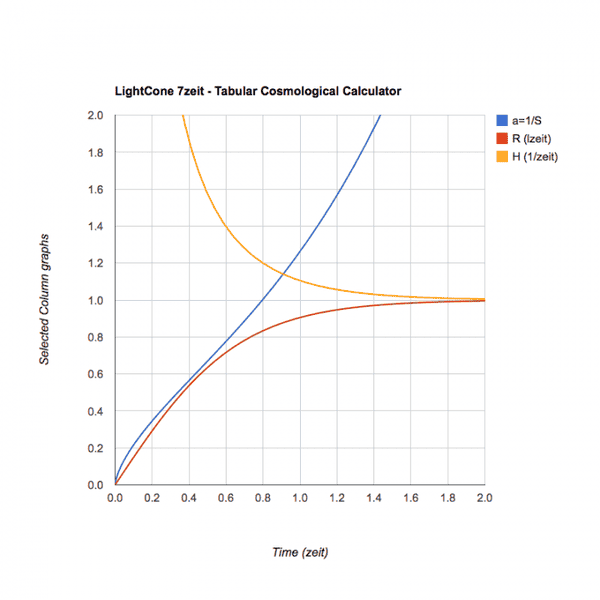

The Hubble growth rate is an instantaneous fractional growth rate, like an interest rate on a savings account at the bank. Distance growth is proportional to size, at any given time in history distances are increasing by some fraction or percentage of their size per some small time increment Δt.
A constant or even slightly declining interest rate will still cause your savings to "accelerate" (grow by an larger dollar amount each year) because the principal is growing. As long as the bank reduces the interest rate GRADUALLY ENOUGH your savings will "accelerate" in that sense.
So Hubble growth rate is DECLINING but with time it has declined more and more gradually and is tending to level out at a positive rate. As the decline has become more gradual the growth of distances has tended to accelerate. So far it is not very dramatic. Here is a picture, in this graph the present is at 0.8 on the x axis. The time unit is a "zeit" = 17.3 billion years. The gold curve is the Hubble rate. The blue curve is the growth curve of a particular distance---curves for other distances would be proportional. They all have an inflection point at time 0.44.

In the picture the blue curve shows the way any given distance grows (like between two galaxies neither of which is moving relative to the space around them).
You can see by looking at the blue curve that there is no "acceleration" until around time 0.45 (actually the exact point is closer to 0.44 but it's hard to tell). At that point the curve changes from convex to concave upwards, the slope starts to steepen. this is "acceleration" of distance growth.
The reason for deceleration, at first, is that the gold curve (the percentage growth rate) is declining TOO STEEPLY
The reason for changing over to acceleration (between time 0.4 and 0.5) is the gold curve now declines LESS STEEPLY.
If the bank cuts your interest rate too rapidly, you savings will not accelerate.
If the bank cuts your interest rate more gradually, slowly enough, you will see "acceleration"---savings grow by more £££ each year.
So we need to look at how steep the gold curve (which tracks the Hubble parameter, the distance growth rate) is decreasing.
The cosmological constant Λ is related to the long term growth rate H.
If Λ = 0 then H = 0. So naturally we will see the H decline more steeply because it is going to zero.
But observations indicate that Λ is positive and more to the point H is positive. so H is still declining as the gold curve shows, but it levels out at a positive level instead of going to zero. that is what makes acceleration in the blue curve kick in at a certain point.
