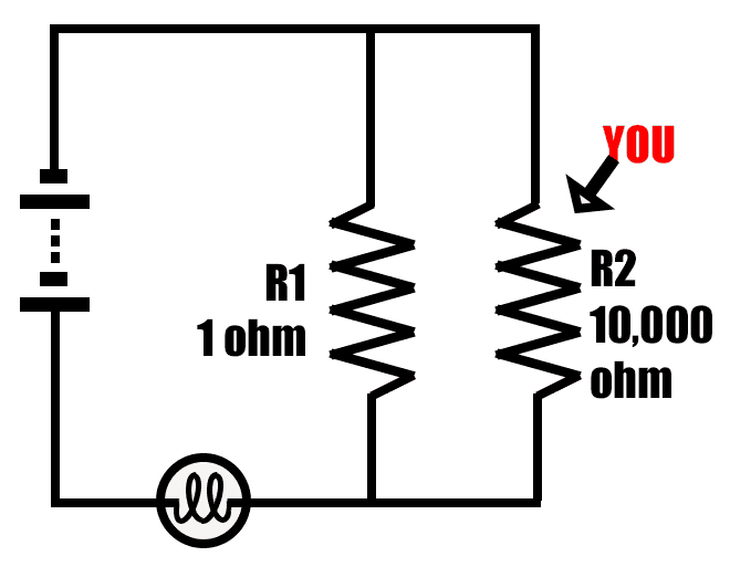

Why do I get electrically shocked when I touch a circuit knowing that the human body has a higher resistance than conductors in circuits and current tends to flow through the path of least resistance?
Have you ever wondered why you can get an electric shock when touching a circuit, even though the human body has a higher resistance than the conductors in circuits? It goes against my belief that electricity always follows the path of least resistance.
That belief is false. Current flows anywhere there is a path available, but it flows according to the resistance of the path; higher resistance means less current, lower resistance means higher current.
The resistance of the body may have a higher resistance than the circuit involved, but it only takes a few milliamps of current to induce a "shock".

You can work out the ratio of wattage that will pass through both paths of this circuit simultaneously.
Not a lot will pass through R2. But it won't be zero.
Likes DaveE and anissbenthami
So I will be considered as a parallel resistance in the circuit
Likes DaveC426913
Exactly.
