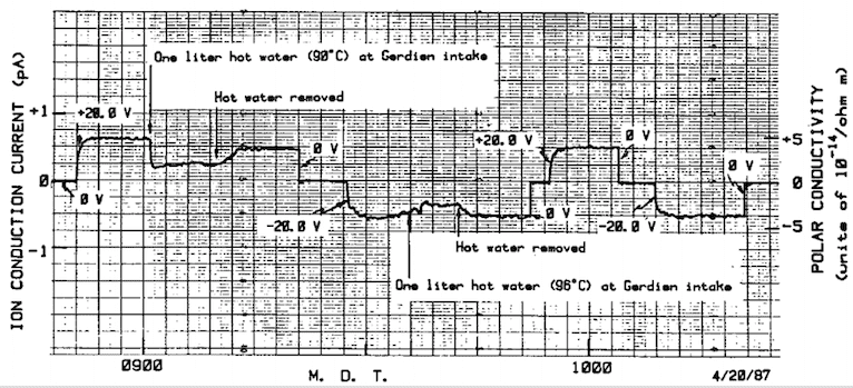

An hour ago, I would have believed you. But my googling indicates otherwise:
Measurements of the Electrical Conductivities of Air over Hot Water
1 March 1988
Page 5
Contrary to the predictions by Carlon, however, no increases in the conduction currents through the air in the system were ever observed resulting from increases in the humidity of that air. Our findings are that the electrical conducting ability of the air within our measuring apparatus is invariably decreased by the introduction of large quantities of water vapor.
Likes greensky

And that's why I spent several hours researching this yesterday, as I had a hard time believing it myself.
[2] the higher conductivity of humid air is why you DONT get a problem with electrostatic discharge during the summer that you do on dry winter days
My only answer to this, is that there is another mechanism that causes this effect.
[3] The higher conductivity also reduces coronal discharge problems associated with very high electric and electrostatic fields
This is probably caused by yet another mechanism.
[4] you will find dozens of references on the net to back that up.
I couldn't find any. But I wasn't looking for "coronal discharges" specifically.
But I did search around the forum to see if a similar question had been asked, and I found:
How does humidity affect conductivity of air?
Where I did not find an answer.
But berkeman asked; "Do you find some graphs when you Google the subject?"
Which prompted me to look for graphs, and I could only one, on the document I referenced:
The graph requires a bit of head scratching, but it can plainly be seen that as humidity goes up, conductivity goes down.
My next quest is: "How on Earth does one measure pico(?)amps?
