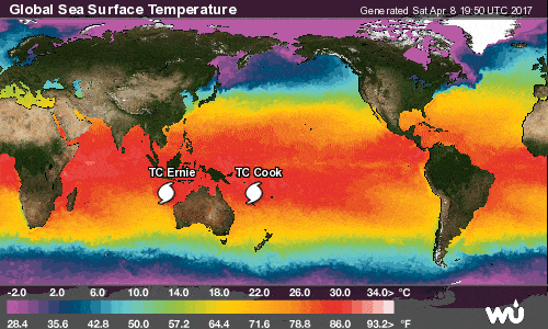

One can watch for the storm trigger, by watching the temps from the NW coast of Africa, over and up into the Gulf of Mexico. Once the sea temps get up into the eighties, the storm activity should start. Consistent with the indicated water temps, hurricane season starts next Tuesday.
http://www.wunderground.com/tropical/
