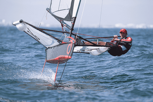

I'm not getting it. Are you designing something like the Moth as shown in this picture?
I just answered to your other post, but I didn't see this one.
No. the Moth is way beyond what I intend to do and I don't plan to rise that high on the wing..
You can have an idea of my hydrofoil wing by looking at the photo I have submitted to Sophiacentaur. I resubmit them for you, My model would be the one in the 1st photo.
