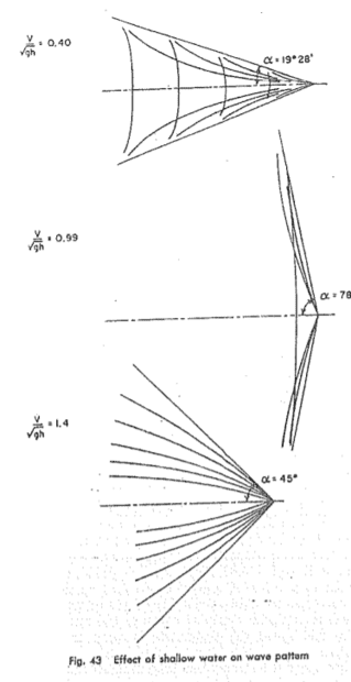

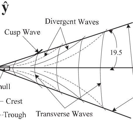

I am studying the hydrodynamics of a ship in shallow water. In deep water the ship creates 2 wave patterns, one transverse and another divergent, both making an angle of 19°28'. Also, the maximum velocity of a wave in shallow water is given by ##\sqrt{gh}## where h is the depth of the water.
The part that I don't understand is why transverse the wave disappears if the ship starts moving faster than ##\sqrt{gh}## ?

Note at 3:06 the video says "supercritical speed: divergent waves are issued at approximately a 45 degree angle, having absorbed the transverse waves"
Actually the 45 degree angle only occurs when ## v_{ship}/\sqrt{gh} = 1,4 ##
Also, one of the most important books in the topic ( Principles of Naval Arquitecture) says
That's why I think they actually disappears. But they don't provide a decent explanation. Ould you think of one?
Well, I think that what they are not showing here is the transversal wave that is in front of the ship (also see the video). This is a kind of shock wave because the ship is exceeding the transversal wave velocity. So by the time the ship has past the damage, so to speak, is already done and no other transversal wake is generated.
