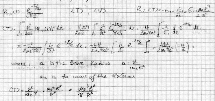

Hello to everybody! This is my first time in PF. I have problems with an QM exercise.
About hydrogen atom in the ground state (n=1), evaluate:
<K>, <V> (expectation value of the kinetic energy and potential energy) and the momentum distribution ([tex]\varphi[/tex](p)).
for now I treat only <K>:
see attachment 009 (<K>=<T>=kinetic energy)
but i know the exact solution so that I evaluate is not right.
where is my mistake??
please help me.
thanks
okay. maybe my attachment is not readble.
the wave function for the hydrogen atom in 1s state is:= [tex]\varphi(r)=\frac{exp(-r/a)}{\sqrt{\pi a^3}}[/tex]
where:
a is the Bohr radius := [tex]a=\frac{\hbar^2}{m e^2}[/tex] ;
m is the electron mass ;
[tex]e=\frac{q^2}{4\pi\epsilon}[/tex] ;
q is the elementary charge ;
now:
to find <K> (expectation value of kinetic energy) I have to evaluate:
[tex]\int \frac{p^2}{2m}\left|\varphi(r)\right|^2 r^2 sin\vartheta d\vartheta d\phi dr[/tex] from 0 to infinity
i.e. = [tex]\frac{(-i\hbar)^2}{2m\pi a^3} \int \partial^{2}/\partial r^{2}[exp(-2r/a)] r^2 sin\vartheta dr d\vartheta d\phi = \frac{(-i\hbar)^2}{2m\pi a^3} 4 \pi \int \frac{4r^2}{a^2} exp(-2r/a) dr = \frac{(-i\hbar)^2}{2m\pi a^3} 4 \pi a = \frac{(-2i\hbar)^2}{m a^2} = \frac{-2 \hbar^2 m^2 e^4}{m \hbar^4} = \frac{-2me^4}{\hbar^2} [/tex]
but the exact solutions found on Basdevant or Sakurai is:= [tex]K=\frac{+me^4}{2 \hbar^2} [/tex]
so...where is my mistake??
please, help me to find it!
[tex]\nabla^2[/tex] is not [tex]\partial^2/\partial r^2[/tex] in spherical coordinates.
ops...it's true...

ok, but I think I know what the error is, you have done things in wrong order:
[tex]\int \psi (r) ^*\Delta\psi (r)r^2dr [/tex]
not
[tex]\int \Delta|\psi (r)|^2r^2dr [/tex]
if you know what I mean. This has to do with the definition of expectation value and general properties of derivative operators.
\Delta is the Laplacian Operator, which acts on everything to the RIGHT.
malawi_glen...you're great...i try to correct it right now!
thanks a lot...
You shold not get 0 now, good luck!
yes! the result is correct! thanks a lot!
