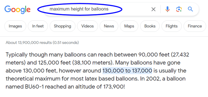

Entropix said:
Above 60000 feet (~18 km) those balloons can't reach or those are meteorological balloons? What's the maximum height those balloons can reach?
You should learn how to use Google. It will be helpful to you with the easy questions
There will ALWAYS be some point where the balloon density becomes greater than the atmospheres's density and the balloon can't go any higher that that. It will always have a density greater than that of the space outside the atmosphere
I trust more PF than google ;) but even from your search we can see 173900 is huge vs 137000. So you see more likely those balloons can't make it very far even taking 173900 as reference. So we can't really know what really happens but just assume thru our current knowledge that balloons stops somewhere upon their fabric, weight and laws of physics that govern there.

They do not need to go higher than 60k ft because there are very few aircraft above 50k ft, and they can hold their position there in the light and variable winds. Their altitude is regulated by using a second internal slightly higher pressure balloon. They usually carry large instrument packages for experimental purposes, solar panels, and communications equipment.
