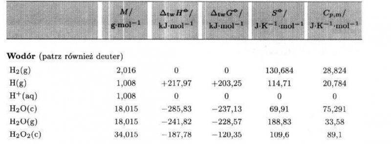

sebastiank007 said:
H+......0.....0.....0
Of all things I don't understand about your post, this is the most striking one. By definition enthalpy of formation is zero for an element in a standard state. H+ is not an element and not in a standard state, so I don't see why its enthalpy of formation is zero.
Don't ask me, ask Atkins...

Took me a while to figure this one out, but I think I got the answer.
First, it is clear that ΔrG° = 0, since this is what you get from the difference in ΔfG° of the products and reactants and from the standard potential (since E° = 0). So the question is then why does the other equation give ΔrG° ≠ 0? It turns out that there is an entropy of hydration for an electron, and it cancels out the entropy of formation of H2(g), such that ΔrS° = 0.
Reference: H. A. Schwarz, Enthalpy and entropy of formation of the hydrated electron, J. Phys. Chem. 95, 6697 (1991).
