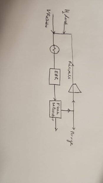

Can you please provide a flow diagram?
You chose as a basis for the calculation 1030 kg residual feed, and you calculated a H2 consumption of 6.49 moles. If the H2 to residue feed ratio is 1000 m^3/m^3, that is a mole ratio of 1000. These two results don't seem consistent to me. What am I missing?
Unfortunately, no flow diagram is provided in the problem. I would imagine a simplified diagram of the process to look like the image below. I used 1030 kg as the basis because the questions are asking for the purge and fresh rates per m³ of residue feed, which is equivalent to 1030 kg. However, I am not sure how the volume of 1000 m3 H₂ in normal conditions per m³ of residue feed corresponds to a mole ratio of 1000. The molecular mass of the residue feed to be processed is not given to determine the mole ratio.
Maybe that mole ratio is in the feed to the reactor
How can I deduce that from the problem givens? I think the 1000 m³ of H₂/m³ of residue feed is referring to the rate of the feed to the ebullated reactor. This was the solution posted for the problem. However, I am not sure how the mole fraction of H₂ in the recycle stream is 0.8 when the composition at the splitting point for the three streams (product stream, recycle stream and purge stream) have to be equal to what’s in the table.

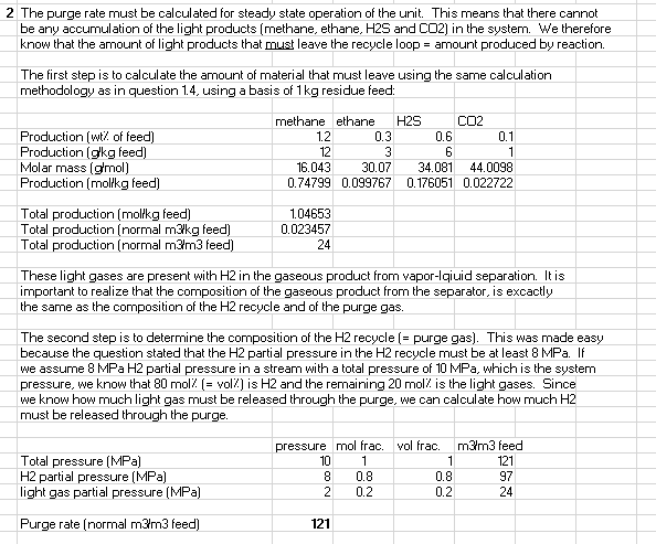

The composition of the recycle steam is exactly the same as the purgee stream. If the partial pressure of H2 is 8 MPa and the total pressure in the system is 10 MPa, the mole fraction of H2 is 0.8.
I'm finally understanding the problem statement better. The basis of the calculation is 1 m^3 of residue stream. Ir seems to me everything you've shown in the calculations so far makes sense.
But If the partial pressure of H2 in the recycle stream is 8 MPa I think the total system pressure would not be 10 MPa. According to Daltons law
Partial pressure of H2=Mole fraction of H2*Total pressure in the system
8=0.9725*Total pressure in the system
Total pressure in the system=8/0.9725=8.225 MPa
Similarly, if we want the total pressure in the system to be 10 MPa then the partial pressure of H2 in the recycle stream would be 9.725 MPa
The mole fraction of H2 in the recycle is not 0.9725.
The problem states that the non-H₂ components cannot be removed as liquid-phase products from the flash separation unit. Therefore, 1.0779 kmol of non-H₂ components produced during hydroconversion will end up in the gaseous stream. This gaseous stream is split into a low-pressure purge and low-pressure recycle stream. If we use the information that the H₂ partial pressure in the recycle stream is 8MPa, and the total system pressure is 10MPa, this means that the mole fraction of H₂ is 0.8. The mole fractions in the gas stream to be split into the purge stream and recycle stream are the same. The amount of H₂ in the gas stream is given by is x/(1.0799 +x)=0.8 x=4.3116 kmol.
I am not sure how the information provided in the problem is enough to determine how much of the gas stream is split between the recycle and purge.

The problem statement, in my judgment, is not precise enough to allow unambiguous solution.
After further thought, here's my tae on this:
Let M = molar makeup H2 feed to reactor/m^3 residue feed
Let R = molar recycle feed to reactor/m^3 residue feed
Let P = molar purge rate /m^3 residue feed
Then $$M=\frac{13.081}{2.016}+0.8P$$
$$M+0.8R=44.615$$
Does this make sense to you?
It makes sense to me expressing the makeup in terms of the recycle stream but not for the purge stream.
Shouldnt the Molar H2 makeup to the reactor=Molar H2 in top stream from the the flash separator + Molar H2 in Purge + H2 Consumed
Molar H2 Feed=Molar H2 Make up+ Molar H2 Recycle
Molar H2 Feed=Molar H2 Unconverted+ Molar H2 Consumed
Molar H2 Unconverted =Molar H2 in top stream from the flash separator+ Molar H2 in bottom liquid product
Molar H2 in top stream from the flash separator=Molar H2 Recycled+ Molar H2 Purged
Molar H2 Make up +Molar H2 Recycled=Molar H2 Unconverted+ Molar H2 Consumed
Molar H2 Make up +(Molar H2 in top stream from the flash separator-Molar H2 Purged)=Molar H2 in top stream from the flash separator+ Molar H2 in bottom liquid product +Molar H2 Consumed
Molar H2 Make up=Molar H2 Purged+ Molar H2 in bottom liquid product+ Molar H2 Consumed
=0.8P+(13.081/2.016)+33.8146=0.8P+40.3032=-0.8R+44.615
I don't think so. I think that the makeup is equal to the converted H2 in the bottom liquid product plus the H2 in the purge stream.
I don't thnk so. The H2 from the separator is equal to the H2 in the recycle plus the H2 in the Purge. The H2 makeup should be the the H2 leaving in the purge + the converted H2 (leaving with the liquid product).
Correct
Molar H2 feed = molar H2 consumed + molar H2 in Purge
The assumption is that the H2 in the bottom liquid product = H2 converted
correct
Likes DumpmeAdrenaline
What a careless mistake on my part! The hydrogen must dissolve in the liquid phase to convert the vacuum residue; it makes sense to me now.
But doesn’t this mean that the unconverted H2 ends up in the top stream from the flash separator? The compositions in the table would correspond to the compositions of the top stream, recycled stream, and purged stream yielding the below equations for the makeup of hydrogen in terms of the purge and recyled streams.
M=(13.081/2.016)+0.9725P
M=(89.9434/2.016)-0.9725R
In thess equations, the 0.9724 should be 0.8
