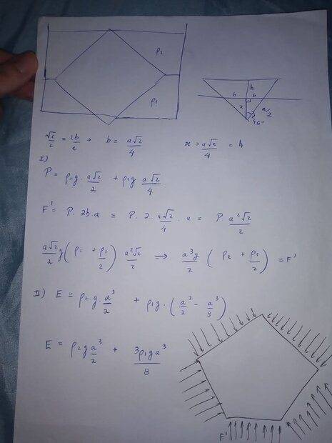

Yeah. This problem is from the Ibero-American Physics Olympiad 2017 but they did not share the solution/answer. I will attach here what I did, sorry for not doing this before.

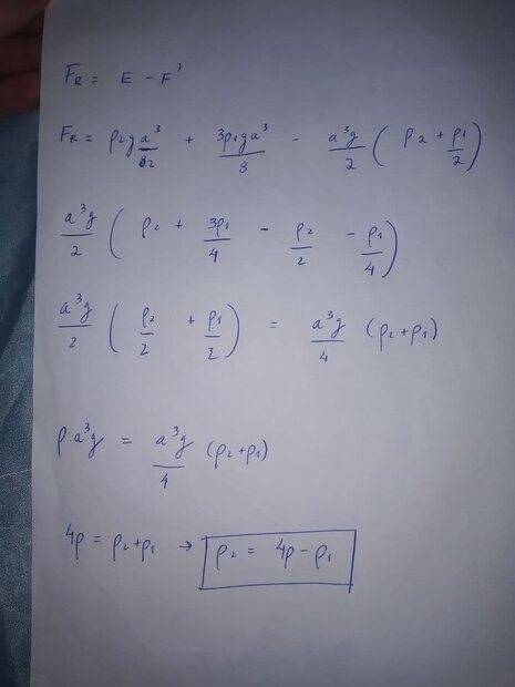

I can't read it. What's your final answer?
𝜌2 = 4𝜌 - 𝜌1

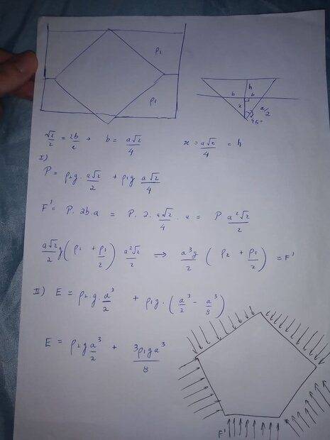

I need some explanation to follow your working.
You start by finding the pressure ("P") at the bottom of the tank, but what is F' exactly? It seems to be the "missing" force, i.e. the force that would be exerted up on the bottom of the cube if you were to slice off the bit the goes below the bottom of the tank, mend the hole in the tank, and allow the liquid to pass under the frustrated cube. Is that right?
But I have no idea how you are defining E.
I considered the forces due to the upper liquid. Above the boundary layer it exerts a downward force computable from the pressure at its average depth and the area it acts on there, while below the boundary layer it is an upward force based on the pressure at its full depth (depth of the boundary layer) and the area below that.
The second pressure is double the first but acts on half the area, so...?

Yeah. P is the pressure at the bottom of the tank. F' is the force that acts on that area due the pressure P. E is the buoyancy force(the famous one E = density of liquid x gravity x volume of body submersed), but here is the main problem of this kind of situation : We cannot just say that E is the total force that acts on the cube since there is a part of the cube who is not surrouded by the liquid (the bottom/ the hole) as you said there is a 'missing' force, so what I did (the famous trick for these problems) was calculating this force F' so now we can just say that the resultant upward force is Fr = E - F'.
E = 𝜌2.g.V/2 + 𝜌1.g.3V/4 (V is the total volume of the cube V = a³)
Fr must equilibrate the weight of the cube = 𝜌.g.V

I confirm your value for the ##\rho_2## term, but I only get 1/3 of your ##\rho_1## term (in the equation for the bottom force). And, this supports not only the weight of the cube, but also the weights of the triangular wedges of the two fluids above.

I don't see a problem with the equation for F', but in the equation for E I get 1/2 of the ##\rho_1## term: ##E=Vg(\frac 12\rho_2+\frac 38\rho_1)##.

For the pressure at the base, I get $$p=\rho_2g\frac{a}{\sqrt{2}}+\rho_1 g \frac{a}{2\sqrt{2}}$$ Is that not what others get?

Yes, but doesn't that match the expression for F' in Photo1? In post #19 I thought you were saying you disagreed with it.

As I wrote in post #22, I think the 3/4 in there should be 3/8.
I had no problem reading the image (I find it works better if I select to open it in a new window), my only difficulty was knowing how your variables were defined.
@ViktorVask has made a simple algebra mistake. Post 10, Figure 2 states:
$$F_r =\frac { \rho_2 g a^3 } {2} + \frac {3 \rho_1 g a^3 }{8} - \frac {a^3 g} {2} \left( \rho_2 + \frac {\rho_1}{2}\right)$$The right hand side is then incorrectly simplified to:$$\frac { a^3 g } {2} \left( \rho_2 + \frac {3\rho_1}{ 4} - \frac{\rho_2}{2}- \frac{\rho_1}{4} \right)$$But this should be:
$$\frac {a^3 g } {2} \left( \rho_2 + \frac {3\rho_1}{ 4} - \rho_2- \frac{\rho_1}{2} \right)$$This then leads to the (counterintuitive) answer explained by @haruspex in Post #13.

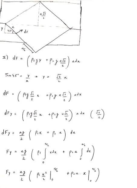

Correct me if I am wrong. I integrated the vertical component of the pressure forces over the surfaces of the cube. On the portion immersed in fluid 2, I got a downward force of ##\frac{\rho_2 ga^3}{2}## and, on the portion immersed in fluid 1, I got an upward force of ##\frac{\rho_2 ga^3}{2}+\frac{\rho_1ga^3}{8}##, so the net fluid pressure force on the cube was upward, and equal to ##\frac{\rho_1ga^3}{8}##, independent of ##\rho_2##. I got the exact same result by calculating the upward force on the base of the stack, and subtracting the weights of the 4 triangular fluid wedges above.

That's what I get also.

Oh yeah,sorry. It should be 3/8 (as in the photo) . I will edit this.

I will try to do it by integrating too. I realized now that I really made a simple mistake and the resultant force is what you found. But now I am a little bit confused, the total force does not depend of 𝜌2 . Isnt that weird ? What should the answer for 𝜌2 be ?

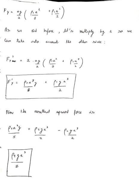

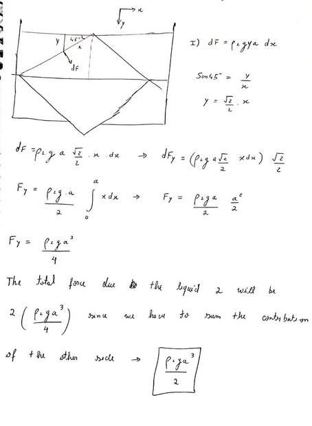

I just did the another solution. I will attach here. Got the same as you again.
In the first photo I calculated the force due the liquid 2
In the second one the force due the liquid 1 (taking into account the pressure that liquid 2 keeps exerting)
The last one I found the resultant
I think now it is okay

  • #34
At first, it does take you by surprise. But the simple explanation is given in the second paragraph of post #13 by @haruspex.
  • #35
Taking it further, if we consider starting with only the denser fluid and gradually add the lighter one, the buoyant force increases but with a negative quadratic term. It reaches a max when the fluid is half way up the face of the cube, then declines to its original value in the diagram position.
Beyond that, the buoyant forces declines linearly, eventually becoming negative overall, so a net downward force.
Likes TSny
