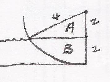

Hi, i would like to know how to do this question for fluid mechanics. Sorry as I am new i didnt know how to upload images so i just uploaded the image in justpaste, here is the link http://justpaste.it/pz7r

Thanks for your reply, what I normally do is use F = pgha to find horizontal component of the force, then use F = phv to find vertical component forces, then I find out the actual force using F^2 = FH^2 + FV^2. However the problem I’m having is finding the vertical component as I don’t know how to calculate the volume of the water that the shape is occupying. I normally work with questions in which the curved surface is fully submerged whereas here it is only partially submerged. The correct answer is meant to be 52050N although I’m not getting it with my current calculations.

Hint: Find area A, then area B.

Interesting, i see where you are going with this, but how would you find the area of B.
You find A +B and subtract A to get B
Ok, i done that. I got A and B now, what should i do with these numbers now?

Area B can get you to the volume of water displaced, right?
How would you find the area of the shape above A, I am asking as i tried subtracting A from the area of the entire semi circle, but in order to find B we need to take into account the area above/next to A.
abuh11 said:
...in order to find B we need to take into account the area above/next to A.
Not really. What are the angles of triangle A? What is the area of the sector of the circle (A+B)?
I don't think we know the angles of A.
Hmm...a right triangle with two of the sides known...you've had trigonometry, right?
yay. I manged to figure it out using your diagram and information. Thanks a lot.
