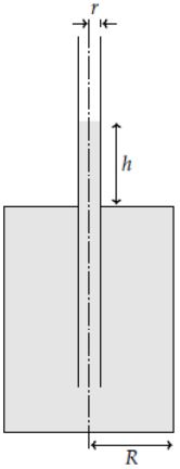

This problem was translated from Swedish, sorry for any grammatical errors present.
The problem
The grey is liquid is water. The small container is a pipe made of glas and the big container is a barrel. Water is poured into the glas pipe. When water reaches 12m over the barrel top(lid) the barrel breaks.
Calculate
a) the mass of the water in the glass pipe (over the lid)
b) the total force on the lid when the barrel breaks
Relevant equations
Liquid - water
h = 12m
R = 0.20m
r = 0.003m
(^^values from below the figure in my book)

There is a hole in the lid so I calculate the area of the doughnut.
The area of the lid is
##A_L = \pi r_n^2 = \pi (R-r)^2 = \pi (0.20 - 0.003)^2 ##
The pressure is
##p = \frac{F}{A_L} \\ F=pA_L = \pi (0.20 - 0.003)^2p ##​

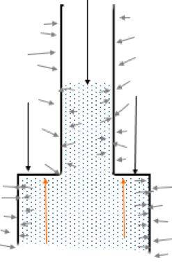

I am not that good at drawing forces, sorry. Here is my attempt:
orange - water's force on the lid
black - air's force on the lid
grey - forces of no interest
I guess that the main problem here is to realize wether that air pressure on the column of water translates into more waterpressure on the lid.
I am sorry but I have no idea how to turn that into a calculation. Thank you for your help so far!
Take the calculation in steps.
How would you calculate the force due to air pressure acting on the outside of the barrel (just the top), assuming that there was no water inside the barrel?
Why not? You did it when the fluid in the column was water.
You already know what the pressure of the atmosphere is. The pressure of the atmosphere and the pressure of the water in the pipe can be added together, since pressure is a scalar quantity.
[EDIT] Remember, we are interested only in the forces acting on the lid of the barrel. The forces acting on the sides of the barrel and of the pipe cancel out and are of no interest anyway, since they are not acting on the barrel lid.
Likes Rectifier

Rectifier said:
##p = \frac{F}{A} \\ F=pA \\##
A is the area of the lid and p is the atmospheric pressure
I think we have established that you know the basics. The question about whether to include atmospheric pressure in your force calculations does not really require any calculation, but a more subtle thing called analysis.
If we look at the drawing you made of the pressure acting on the barrel:
We see that the orange arrows represent the hydrostatic pressure acting on the lid, but since the pipe is open at the top, the atmospheric pressure must be added to hydrostatic pressure produced by the column of water in the pipe. So, your orange arrows should also have a bit extra added to them due to atmospheric pressure.
However, the black arrows show atmospheric pressure acting on the outside of the lid of the barrel, separate from what internal pressure is produced by the water + air pressure acting from the pipe. What to do?
Likes Rectifier
My thoughts now are to calculate the black force on the lid and the hydrostatic pressure on the other side of the lid.
## F_T = F_O - F_B \\ F_B=A_Lp_{atm} \\ F_O=A_L(dgh+p_{atm}) \\ F_T = F_O - F_B = A_L(dgh+p_{atm}) - A_Lp_{atm} = A_Ldgh ##
Am I on the right track?
The downward force on the top of the lid is ##p_{atm}A_L##. The upward force on the bottom of the lid is ##(p_{atm}+dgh)A_L##. What is the net of these forces?
Chet
Likes Rectifier
Chet
I think I got it :D take a look on my comment above. Thank you for your tip :)
Yes. I posted it right before you posted your result. Your answer is correct.
Chet
Likes Rectifier
