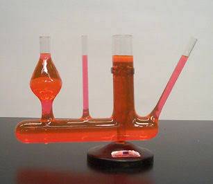

Prove that the hydrostatic pressure difference between the liquid surface and the base of rightmost tube is ρgh (h is the vertical distance of the liquid surface from the base ) ?
I would like to prove this result just out of curiosity .
The tube is tilted at an angle θ with the vertical . Tube length is L .
Consider a small cuboidal shape fluid element of base area A and height dx at a distance x from the base of the tube .
Weight of the fluid element = (Adx)ρg
Since the fluid is in equilibrium , the net force along the length of the tube is zero .
If P (x) denotes pressure at a distance x from the base ,
P(x)A - P(x+dx)A - (Adx)ρg(cosθ) = 0
dP = ρg(cosθ)dx
P(0) - P(L) = ∫ ρg(cosθ)dx
= ρgL(cosθ)
= ρgh
Is this derivation correct ?

That seems correct to me.

If we consider the rightmost tube to be a thin capillary tube such that the surface has a curved meniscus , will the pressure at the base still be P0+ρgh ?
Actually I want to ask whether surface tension is relevant as far as hydrostatic pressure in the liquid is concerned ?

Surface tension causes a pressure difference across the free surface. So, do you think this matters?
Taking surface tension into account ,pressure at the base would be P0 - 2T/r + ρgh . Right ?

Yes, for a hemispherical surface contour.
