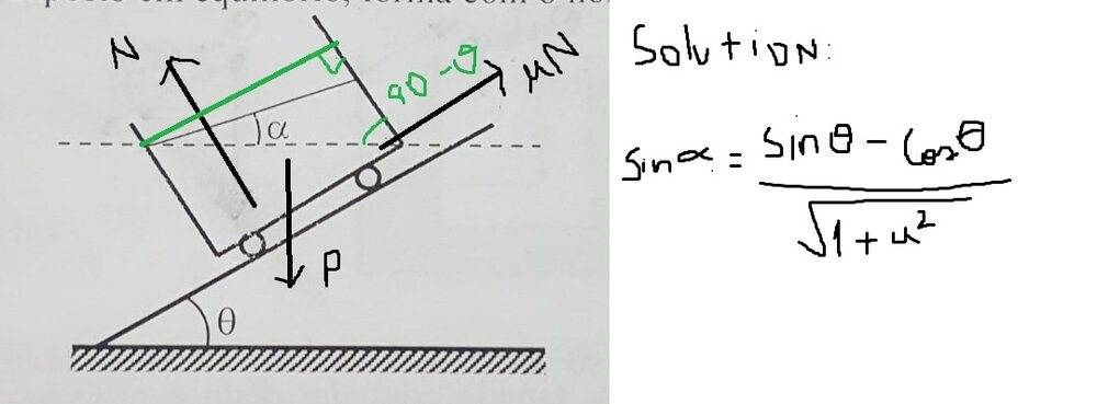

A tank car partially filled with a homogeneous liquid travels at a constant acceleration along a straight slope of the road, inclined from a angle θ to the horizon and which has a kinetic friction coefficient equal to μ. Determine the alpha angle that the free surface of the liquid, supposed to be in equilibrium, forms with the horizon.
P= mg
F= μN
Sorry for my English, I'm Spanish. I am not able to make the force diagram for the liquid. I am still in high school and started now little hydrostatic. If someone can give me a light, I would be very .grateful.

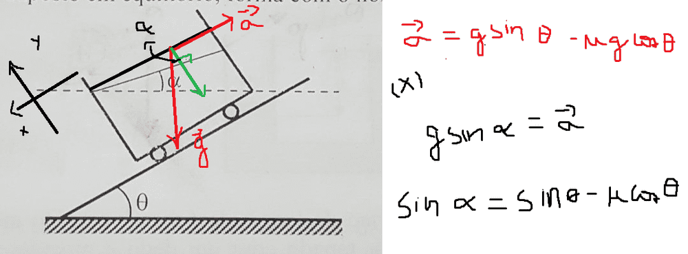

Hello!
I used non-inertial frame:
I can't found
the denominator value
what am i missing

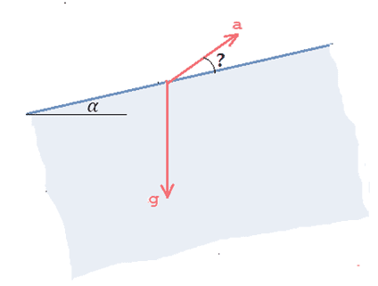

A13235378 said:
You drew a green vector that is perpendicular to the vector ##\large \vec a##. You then indicate in the drawing that the angle between the green vector and the vertical is equal to ##\large \alpha##. But this is not correct. Did you mean to draw the green vector perpendicular to the surface of the fluid instead of perpendicular to ##\large \vec a##?
The principle that you can use is that the components of ##\large \vec a## and ##\large \vec g## that are parallel to the surface of the fluid must add to zero. It looks like maybe this is what you were trying to express. What is the angle that ##\large \vec a## makes to the surface of the fluid?
Yes! The green vector is perpendicular to the surface of the fluid. Its correct, right? So i just changed the balance equation?
Yes, if the green vector is meant to denote the vector sum of ##\vec a## and ##\vec g##.

A13235378 said:
This should read ##\sin \alpha = \large \frac{\sin \theta - \mu \cos \theta}{\sqrt{1+\mu^2}}##.
