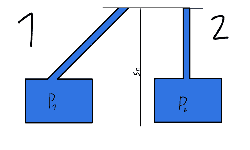

Jun 25, 2024 #1 abrek 5 1 In the photo there are two identical containers with pipes extending from the top of the same height but at different angles, will the pressure created by the column of water differ depending on the angle of the pipe?
Jun 25, 2024 #2 berkeman Mentor 67,599 20,851 What are your thoughts on this question? What is the equation that gives the hydrostatic pressure at a depth below the surface of the liquid?
