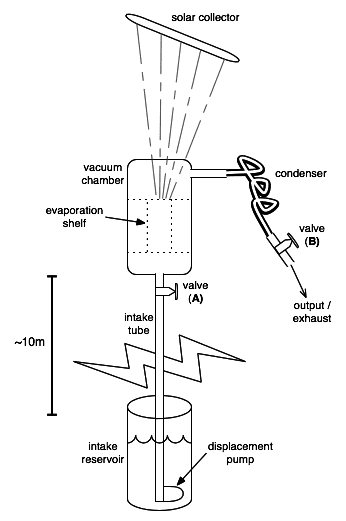

Hey, I came across this idea a couple of years ago. It's been a long time since I took introductory physics. But I'm curious as to whether this is feasible. If I'm crazy, just say so!
See attached image.
1. Intake tube, vacuum chamber and condenser are initially filled with water. Valve (A) remains open; valve (B) is closed. Vacuum chamber and condenser are raised to a height more than 10 meters above the intake reservoir.
2. Condenser is temporarily oriented such that its contents can drain into the chamber while the hydrostatic vacuum is forming. Water level in the intake tube settles at a height about 10 meters above the reservoir, balancing atmospheric pressure, while a vacuum is sustained in the chamber and condenser above that height. Valve (A) is closed.
3. At this point, the shelf inside the vacuum chamber has retained a significant amount of water from draining back down the intake tube. A solar collector focuses sunlight through the top of the glass container to slightly warm this water (>80˚F).
4. The warm water rapidly vaporizes in the presence of the vacuum. Water vapor diffuses into the condenser tube, condenses and accumulates at valve (B).
5. There must be enough space between the condenser and valve (B) to hold the same volume of water as does the evaporation shelf in the vacuum chamber. Once the transfer is complete, valve (B) is opened to discharge the distilled liquid. (Obviously there should be a separate valve on the chamber to let in atmosphere lest we blow the distilled water back inside).
6. In order to restart the process, both valves are opened while the displacement pump refills the vacuum chamber and condenser with water. Condenser is temporarily raised/oriented such that its contents do not flow out the open valve (B).
7. Once chamber and condenser are filled, valve (A) remains open and valve (B) is closed. Return to step 2.

Sounds similar to a flash distillation system, where water is heated to a certain temperature, and then let into a chamber which has a reduced pressure.
If the water is heated to a temperature above the boiling point at chamber pressure, then pure water will flash into steam, which can be collected and condensed.
This is one type of water maker used aboard ship.

i think your concept is valid in principle.
in practice i expect you'll have trouble with gases other than water vapor.
Real condensers have "air ejectors" to remove noncondensibles. Most general purpose water contains dissolved air.
The 'air ejector' is a substantial vacuum pump. Mine were steam powered so it's hard for me to put a number on their power requirement.Steamking probably knows more than i about evaporators. We made our boiler water by ion exchange resin beds.
Real condensers have "air ejectors" to remove noncondensibles. Most general purpose water contains dissolved air. The 'air ejector' is a substantial vacuum pump. Mine were steam powered so it's hard for me to put a number on their power requirement.
Thanks, that's what I was looking for. I guess you're saying that the escaped air will increase the chamber pressure enough that the water's boiling point will rise too much and nothing will happen. These figures seem to suggest that the pressure increase wouldn't be significant. But maybe they're wrong:

Nice calc!
23milligrams = 23/29 millimole , or about 17ml at STP.
If you remove that 17 ml between cycles you'll be okay
just be aware it doesn't condense so will have to be removed mechanically.
At 1/.017 = 56, so at 1/56 atmosphere it'll occupy a liter
is that 1809 pascals?
In theory, 0.1668 inHg shouldn't really affect the boiling point that much?
My steam tables are packed away, so can't check. But you're right, not a lot. Just don't let it accumulate in your chamber.
Lastly - remember that air is denser than steam, molecular weight is 29 vs 18, so it'll accumulate in the bottom.

Maybe I'm missing something. In step 5 atmosphere is let back into the chamber before repriming with water. (Via the displacement pump). It seems to me that the entire 3.5 L of air (including the original 17mL) is just forced out of the chamber because it's lighter than the incoming water.
I'm failing to see why a mechanical vacuum pump is needed between cycles. But my education is an A.S. Math, so that could be the problem here :rolleyes:

Wow thanks- I just realized you indirectly answered my big question! A flash distillation system uses multiple stages because once the pressure of the vapor reaches a certain point, no more water can evaporate and we have to restart the cycle. So this system probably won't produce 1 L for every 42 J. The rate could be much lower. Hmm...
My mistake not yours, i just didnt realize you were removing all the air in step 5.
I gather you completely fill the chamber with your displacement pump at bottom?
That'd displace the air provided your vent is at top. Displacing air with water is mechanically removing it, just i didn't get that from your word picture. I have a touch of Asperger's and tend to miss subtleties...
