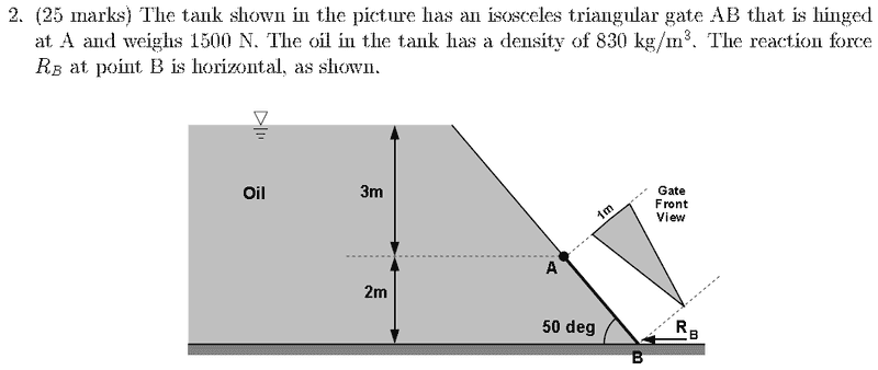

The question asks to find the magnitude of the pressure force on the gate:

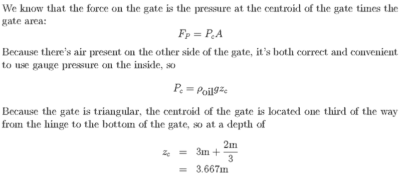

Here is the part of the solution:
I don't get why zc is 3.667m. Shouldn't it be 3 + (2/3)sin40 since you want the depth of the centroid from the surface to the gate?
Also, another way to solve this would be to find the horizontal force and vertical forces. This would mean that I would have to for the weight of the fluid under the gate in order to find the vertical force right?
If you draw the location of the centroid of the triangular gate on the diagram and work out the trigonometry, you will see that the location of the centroid in the problem statement is correct. Remember, the length of the gate from A to B is 2 / sin 50. You then draw 2/3 of this distance from B on the Front View. Working back from this point to the surface, you will see zc is 3.667 m.
Ah that makes a lot of sense, thank you.

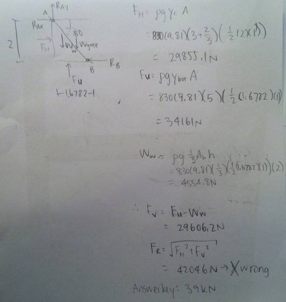

So I decided to try the other method I mentioned where you take the magnitude of the Fhorizontal and Fvertical. However, my answer is off by around 3000N (the answer key gives 39000N). Do you guys know what is wrong?
Just check the vertical component of the hydrostatic-pressure force. I'm getting it near 25 kN.

Hmm... First off, am I right about the fact that there are only two vertical force - weight of the water and the projected vertical upwards force?
Also, I wasn't sure if I should include the weight of the gate in the vertical force calculations... Even if I did the answer isn't 25kN.
Yes those are the only vertical forces.
Now excluding the weight, net force due to hydrostatic pressure*sin40 is the vertical component.

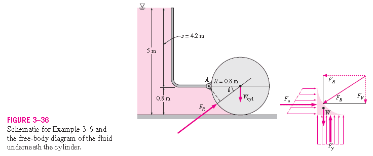

As for the integration method, how can you use integration for the curved circular gate example from the textbook?

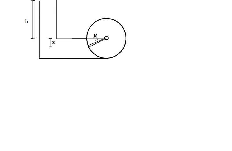

I am no expert. The y_component of force when calculated using integrals doesn't match the book's answer but x-component of force does.
The pressure at height h+Rsinα is P=ρg(h+Rsinα), the force acting on area dA is dF=PdA, where dA=Rdα. The direction of this force is radially towards the centre.
[tex]dF_x=dF\cos \alpha=ρg(h+Rsinα)R\cos \alpha d\alpha[/tex]
Integrating the expression within the limits 0 to pi/2
[tex]F_x= ρgR\left(h+\frac{R}{2}\right)[/tex]
which matches with the book's answer. However,
[tex]dF_y=dF\sin \alpha=ρg(h+Rsinα)R\sin \alpha d\alpha[/tex]
[tex]F_y=ρgR\left(h+\frac{\pi R}{4}\right)[/tex]
I would like an expert to comment on this.

I'm no expert either, but your calculation looks correct to me. It agrees with the solution in the figure in post #9 where the vertical force on the cylinder would be ##F_V = F_y - W##. Here, ##F_y## is the vertical force on the horizontal bottom surface of the volume of water below the cylinder as shown in the figure and ##W## is the weight of that water.
Thanks TSny,
According to our calculations, the vertical force due to the water would be 37.892 kN while the textbook says 39.2 kN. Though the difference is small, the answers still vary because of the methods used to obtain them.
So, my question is whether the textbook's method is an approximation. If so, how far is it valid or is there a limit after which the approximation fails?
I believe the 37.892 kN is the correct answer for the vertical force on the cylinder; whereas, the 39.2 kN is the correct answer for the vertical force on the horizontal bottom surface of the water that lies beneath the cylinder. The difference of these equals the weight of the volume of water that lies vertically beneath the cylinder.
I have a few doubts,
1. So are (referring to the diagram), Fv=37.892 kN and Fy=39.2 kN?
2.To find the weight per unit length of the cylinder, shouldn't Fv=37.892 kN be used as it is the vertical force component on the cylinder?
Yes.
In going to part (b) where you want to find the weight per unit length of the cylinder, you should think of a free body diagram for the cylinder. Note that there will be horizontal and vertical components of "reaction" force at the hinge acting on the cylinder. These would have to be included in summing the forces in the horizontal and vertical directions. I think torque would be the way to go for this part.
Okay, so torque about the hinge is because of the vertical component of the normal reaction i.e. Fy and weight of the cylinder itself. Both act along the same distance from the hinge i.e. R(radius).
So when the water is just about to exit, the two should just balance each other and thus, Fy=mg
So 37892=m*9.81
or m= 4066 kg (per unit length of course)
Is this right?

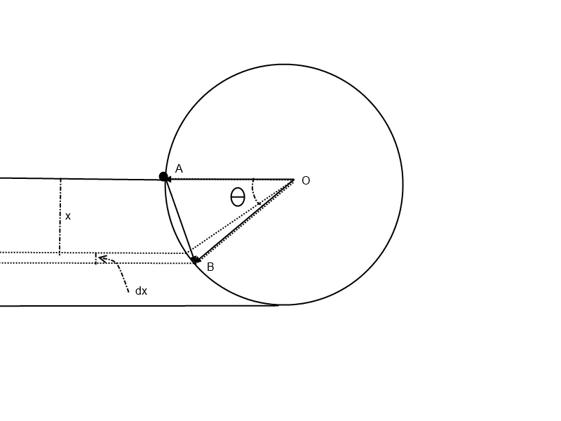

Okay so, the figure I shall refer to in the following derivation is in the attachment.
So the force due to hydrostatic pressure at a depth (h+x) is
dF=ρg(h+Rsinθ)Rdθ(cosθi + sinθj)
And the radius vector from the hinge to that point is
r=R(1-cosθ)i-Rsinθj
So the differential torque is
=r x dF
or = R2ρg(Rsinθ + h)sinθ.dθ k
Hence net torque is τ = R2ρg(R∏/4 + h)k
Which is the same as the torque due to vertical component of the force acting at the center

Well, in the midst of all this discussion, we have completely ignored theBEAST's original question:redface:
By the way theBEAST, I think you are getting a wrong answer because ρghbottomA is actually the force on the water beneath the gate due t hydrostatic pressure. The vertical component of force on the gate is actually that force minus the weight of the water.( See your own diagram at post #3; the vertical component of force on the water is simply mg-Fu)
  • #32
It looks to me that the textbook solution is correct as far as shown. But, if the textbook is claiming that the force ##F_y## is the same as the vertical force on the cylinder, then, yes, the textbook is wrong. The vertical force ##F_V## on the cylinder would be ##F_V = F_y - W## where ##W## is the weight of the water below the cylinder as shown in the figure in the textbook. I'm wondering if the solution in the textbook continues onto another page that was not posted.
  • #33
Yes that sounds right. Sorry for the last second edit
  • #34
I think you're off by a factor of 2 in finding the weight of the water. In particular, look at how you found the area of the base of the region of water.
