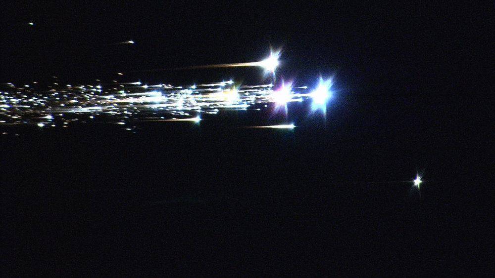

The color of very hot (reentry) shocks may be white, blue or even violet (although violet is possible to view only on panchromatic photos, not visually, because human eye is not very sensitive to violet). Green is possible due ablative carbon flourescence in hydrogen/helium atmospheres only (this is largely speculative - nobody yet got a good photos of gas giant reentries).
Photo below is the Hayabusa spacecraft reentry on Earth at 12 km/s.

It was a rapid scheduled disasembly. Spacecraft have just jettisoned reentry capsule and was burning the rest of chassis. Hottest temperatures on that photo (for violet-halo) was at least ~12,000 K, and about ~8,000 K for blue halo, assuming panchromatic camera. May be even more if camera is color-corrected.

Hayabusa reentry at 12 km/s was a bit of extreme speed (ISS return is at 8 km/s and Moon return is at 11 km/s). Therefore, more bluish reentry colors on photo i inserted. Also, windows of manned spacecraft are always pointed diagonally rearward, wherefore you cannot see hottest part of reentry glow from spacecraft (actually if you will see 8000K blackbody glow from inside of spacecraft , the occupants will fry in seconds even if window will not fail).
