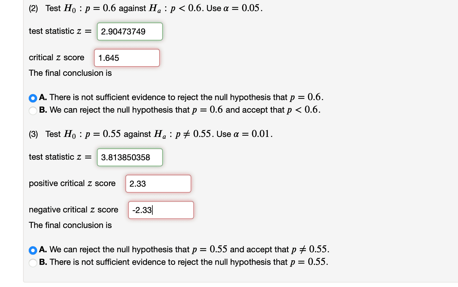

It looks as if question (2) asks about a left sided hypothesis.
The critical z-value should then typically be $-1.645$.
Where did you get the test statistic z?
To reject the null hypothesis, we need that the test statistic z is more negative than $-1.645$.
In question (3) we have a 2-sided hypothesis.
It means that we need to find the critical z-value for $\frac \alpha 2=0.005$, which is $\pm 2.5758$.

And my problem with question 3 is the z critical values. It says 2.33 and -2.33 are wrong, but on the table those are the values that correspond with an alpha of 0.01
Question 3 has a 2-sided hypothesis. We need the values that correspond to alpha/2=0.005.
Question 2 has a left-sided hypothesis. You probably need a minus sign in front of the critical z-value.

Okay that's exactly what was wrong. Thank you so much for your help!
