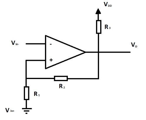

Hello,
I am designing a circuit which basically takes two voltages (V1,V2) and based upon which one of the two is greater, turns corresponding LED. So, I have got to the part where I have output from differential op amp that is the input of the inverting voltage comparator with hysteresis. Comparator compares that voltage with ground, which tells me whether that voltage is positive or negative or V1>V2 , V1<V2 . Comparator is shown bellow.
Minimal input voltage is ±0.72V, voltage used to power the comparator is 12V, resistors are not known.
Questions:
  1. What is the ideal hysteresis voltage, a little less than minimal input voltage?

When the comparator switches between low and high output voltages, that voltage swing appears at the non-inverting input, attenuated by the R1 + R2 potential divider.
But, what is the purpose of R3?
R3 is called a "Pull Up Resistor".
Its purpose is to "pull" the output pin to a high state.
That let's you use the comparator to drive logic level circuits where the maximum permissible voltage might be 5 or 3.3 volts not the 12 used by your analog circuitry.
Many comparators are built with no internal output current (high) drive for their output pin, they can only sink current to pull the pin low.
That's on purpose so you can use them to interface between analog and logic circuits that use different supply voltages , and to let you connect several outputs in parallel for "wired or" logic.
It's called "Open Collector" or "Open Drain" .

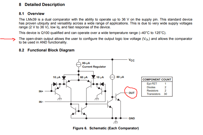

here's the inside of a TI LM139 comparator , from http://www.ti.com/lit/ds/symlink/lm239a.pdf
So, to your question - R3 provides current to drive the output to its high voltage state, ie "Pull it up" .
