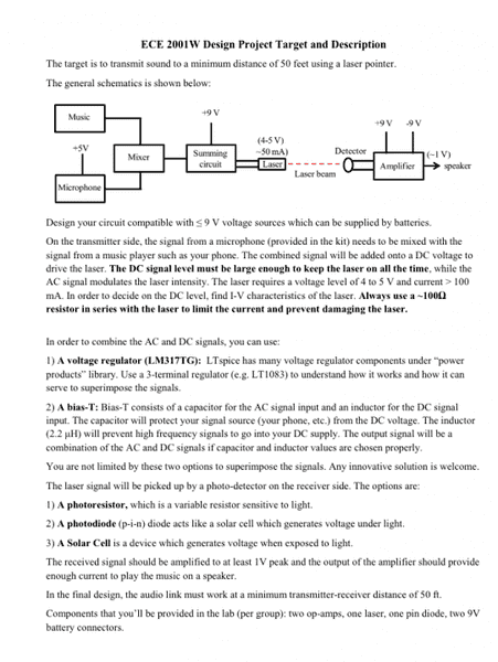

Hey everyone! This is my first post here so take it easy on me!
Before I get into the circuit I'll give a little backstory here. I'm a business student at a US college right now and I have a good friend who is a Biomedical engineering student. We were arguing about whether or not I would be able to do what she does in her classes. Being rather impulsive and overconfident, I bet her that I could design the final project from her toughest class in two weeks. That may have been my first mistake, but I consider myself a smart guy and I love a challenge like this one, especially since I've always had an interest in learning about circuits. If I pull it off, she's agreed to take me on an all expenses paid long weekend vacation to wherever I choose so I'm pretty motivated and since it's the summer I have plenty of time on my hands to do it. The rules are that I can use any help that would have been available to her when she was taking the class (so forums, any software, my engineer father etc...) and I must use the materials in the kit from the class and it has to satisfy the rubric with a passing grade
Now onto the technical stuff. Keep in mind I have NO background or experience in much science at all honestly so this stuff may as well be in Chinese to me at this point. I've uploaded the rubric for you guys to check out. I imagine it must seem pretty basic to you as professionals in this field so I'm hoping that some of you may enjoy this story and decide to guide me a little in this endeavor.
Here are my questions so far:
Where should I start? What concepts should I begin by learning that are necessary for this circuit?
What software should I download?
And, in general, if you were in my position what approach would you take in taking on this challenge?

I think you should start with the problem statement. Do you understand the significance of every word in every sentence? How the words relate to the diagram?
Perhaps you could paraphrase the entire problem statement in your own words and post it here. We can help by telling you if you got it right.

Not a very original problem. Try googling send sound with a laser.
I did this exact project for a class 20 years ago, except we used a fiber to send the audio rather than a laser pointer. It's actually pretty simple if you know what parts to use and how to design an op-amp amplifier.
Free hint: don't use a solar cell.
Do you have any specific questions for us? I'd start with trying to understand and build the receiver side. Clearly, since you are only given a photodiode, you will be using that to detect your laser light. You'll obviously have one op-amp at the receiver and one at the transmitter.
First I would print out the datasheets of your components even if you don't understand them yet.
To give you another vague hint I'll tell you that for your transmitter you need to amplify(?) and shift up your AC audio signal into an appropriate DC signal to power your laser. You can do that easily by adding your audio signal to an appropriate voltage using the first op amp and the right resistors. Check out schematics of an op amp "summing" circuit online.
Then you'll need to detect the laser light with your PD. You can do your own research on how to do this. (hint: reverse bias the photodiode and then measure the voltage generated across a resistor placed in series with the PD since the PD produces a reverse current that is roughly proportional to the light intensity) You'll use the second op amp to kinda do the opposite of the first op amp (shift down your DC signal into an AC signal that can drive a speaker). Hope that helps.
