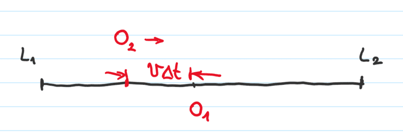

Hi everyone,
I'm struggling to grasp simultaneity in Special Relativity. Since I am struggling conceptually, I have posted my question here. But if you think this problem I made up modified should go to homework, I apologise (and feel free to move it).

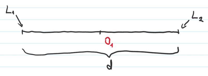

Suppose we have two light sources, ##L_1## and ##L_2##, with distance ##d## between them. We have an observer (##O_1##) located at the midpoint who can control (activate) these lights at any given time.
This observer measures proper distance between sources as ##d##, and knows that every time he presses the switch, light rays meet at the midpoint. The time it takes for light to hit the midpoint is constant: $$\Delta t=\frac{d}{2c}$$
Next, suppose there is ##O_2## running towards ##O_1## in the positive ##x## direction. ##O_1## sees him moving with speed ##V## towards the centre.
In reference frame of ##O_1##, as soon as ##O_2## gets to ##V\Delta t## from the centre, ##O_1## activates the light switches. Let's call this ##t_0##. By the time ##O_2## gets to the centre, ##O_1## will observe light rays will "hit" the runner from both sides simultaneously. Let's call this ##t_1##.
My question is - what does ##O_2## observe? How does the "world" look for him?
I know he will measure distance between the sources as ##\frac{d}{\gamma}##, but does contraction occur symmetrical to his location? How does that affect simultaneity of events?
How do things "look" for him at ##t=0##? Since he is closer to ##L_1## than to ##L_2##, does that mean he sees ##L_1## first? But light was still transmitted simultaneously - just because you see light from one event sooner than light from another, that doesn't mean events happened at a different time, no?

O2 will measure that, at the time of the light emission, L1 was closer to him than L2 (the difference is ##\frac{2v\Delta t}{\gamma}##) - but the light from both arrived at the same time. L1 must have switched on later.
Ok, I'm following. I managed to derive this.
Ok, so the light sources switch on at different times, but light illuminates ##O_2## simultaneously. My intuition tells me that the faster ##O_2## moves, the greater is the the perceived discrepancy in activation of ##L_1## and ##L_2## (in his reference frame). Would you agree? And if so, is it possible to quantify the degree to which simultaneity brakes down (i.e. time interval between the two)?
That's a single event, and as such it's invariant. All observers will agree on it.
The same thing, that the light rays hit simultaneously.
There is nothing relative about this kind of simultaneity. It's only when two separate events occur at two separate locations that simultaneity is relative.
The events in this case that demonstrate the relativity of simultaneity are the emissions of the light pulses. Those two events occur in two separate locations, and therefore they cannot be simultaneous for both ##O_1## and ##O_2##.
In this case ##O_1## will conclude they're simultaneous, but ##O_2## will conclude that the flash coming from in front of him must have left first because it had to travel further.
You are, at least subconciously, looking at this problem as though ##O_1## and the lighting apparatus are "really" at rest and ##O_2## is really moving.
To see what happens in ##O_2##'s reference frame you need a new diagram where ##O_2## is at rest and ##O_1## and the length-contracted lighting apparatus is moving towards him.
In this frame it's clear that the if the light emission events are simultaneous, then the light pulses do not reach ##O_1## simultaneously. And, if the light pulses reach ##O_1## simultaneously, then they cannot have been emitted simultaneously.
