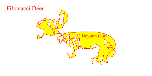

Another creature, named Fibonacci Deer, was found together.
Just by changing the first two number to 1, 5:
Code:
from turtle import *
j, k = 1, 5
while True:
    i = j + k
    j, k = i, j
    forward(20)
    right(i % 360)
Can anybody give me a mathematic interpretation? Thanks!

I don't know why it becomes an closed curve and why it looks like this..

Perhaps the explanation is like this:
Why:
Ʃ(sin(F(i)/180*PI)) = 0
Ʃ(cos(F(i)/180*PI)) = 0
i = 0 to 119
F(i) is the ith number in Fibonacci sequence.
I'm not able to prove these equations, I just happened to find these facts...
DeyuanGuo said:
I don't know why it becomes a closed curve
Now that is the interesting part of the question no one has tackled so far.
It amounts to saying that[tex]\sum_{i=1}^M \langle r, (s_i \mbox{ mod } 360) \rangle = {\bf 0}[/tex]for some integer M, where <r,a> is notation for a two dimensional vector in polar coordinates (a vector with magnitude "r", the 20 in the Python programs, and direction "a" degrees), and [itex]s_i[/itex] is some integer sequence, Fibonacci or otherwise.
Notice that a (non-zero) constant sequence will satisfy the statement above, drawing regular polygons: for example, the constant sequence {90,90,90,90,...} will draw a square, and the sequence {1,1,1,1,...} will draw the 360-sided regular polygon.
Similarly, consider a periodic sequence with period P; that is, a sequence where the numbers repeat every P numbers. Take, for example, the sequence {11,22,33,11,22,33,...} where the numbers 11,22,33 repeat indefinitely. Let the vector <R,A> (again in polar form: a vector with magnitude R and direction A, with A in degrees for our purposes) be the sum of the P vectors with angles taken from the period: the sum of <20,11>, <20,22>, <20,33> in this example. In the long run, the drawing with the periodic sequence will go to the same place as the drawing of the constant sequence {A,A,A,A,...}, using a vector magnitude of r=R (instead of 20) in the statement above. Thus, a closed curve (as long as the angle sum A is non-zero modulo 360).
In summary, the figure will be closed if the Fibonacci sequence (or the other one) modulo 360 is periodic (as long as the period adds up to a non-zero number). The fact that these Fibonacci-like recurrence sequences are periodic modulo some number is not hard to prove; see the first few lines near the beginning of
http://www.math.temple.edu/~renault/fibonacci/fib.html
specifically, paragraph A.2. The part of the sum of the period being non-zero was just luck; for example, starting with 0,180 (instead of 1,1 or 1,5) would have not produced a closed curve.
P.S.:
There are a few loose ends in my argument above.
  • The sequence will eventually be periodic modulo 360... but it could have had a non-periodic startup before becoming periodic. For example, the sequence {1,2,3,4,5,4,5,4,5,4,5,...} begins with 1,2,3 and THEN enters the endless period 4,5. This means that the drawing could have had some curve wandering about, and THEN draw a closed curve from that point on. The fact that it draws a closed curve from the beginning is still unexplained. (But I have to go to work now!)
  • Each periodic repetition draws some curve, which may look like a "petal" of a flower; when repeated, the succession of "petals" will end up drawing a closed curve, the whole "flower". (This is a summary of what I tried to say in my previous post.) The resulting curve should have looked like one of these old "spirograph" drawings,
    http://www.thefirstfew.com/2010/04/spirograph-retro-toy/
    In other words, the result could have easily been one monster... then another monster at an angle, then another, and another... giving a succession of monsters eating each other's tail, until completing a closed "polygon" where each side is a monster, instead of just a straight line. But we got exactly just one monster, not a succession of monsters following each other. This is still unexplained.
And by the way, DeyuanGuo... a very funny subject it is, congratulations. :)
