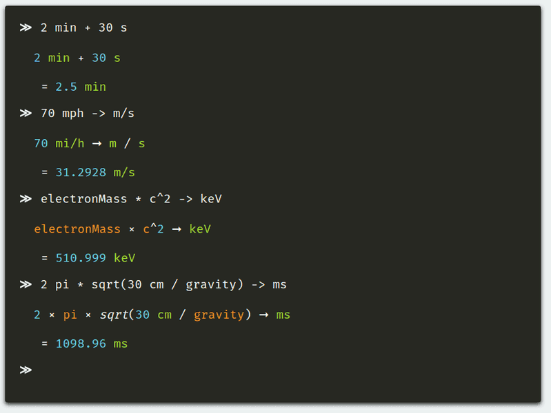

Hi!
My name is David. I'm a theoretical physicist from Stuttgart, Germany. Over the past months I have been developing an open source application called Insect, which I hope would be of interest to some of you. Insect is a high-precision scientific calculator that comes with full support for physical units. Here's a short demo:
You can try the web-version here: https://insect.sh/
The full documentation, the source code and a terminal version are available here: https://github.com/sharkdp/insect
Anyway, I would really love to hear your feedback!Full disclosure: This is my first post on this forum. I was careful to read the Forum Guidelines and I hope that this post does not contradict any of the rules. There is no personal gain for me: Insect is an open-source project and is completely free.

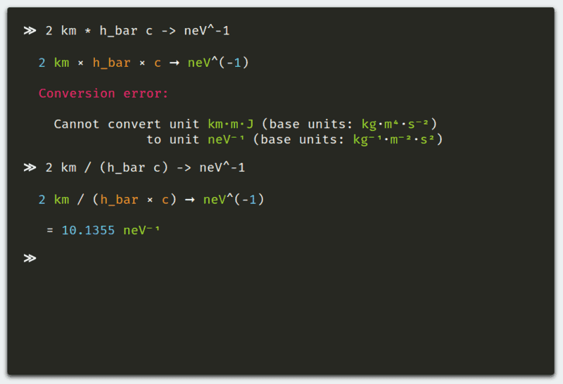

As a particle physicist, I would like to see support for different unit systems, in my case natural units. Converting km to eV^-1 is tedious and error prone. I currently usually use Wolfram Alpha for fast conversions, but there as here you need to get the appropriate factors of c and hbar in there. It would be significantly more convenient to just type 1 km -> eV^-1.
Likes Stavros Kiri
Thank you for the feedback! A similar request has been discussed here: https://github.com/sharkdp/insect/issues/112
I'd be happy to re-open the ticket to discuss this again.
I can understand why it is tedious, but error prone? Using a calculator that understands physical units, there is actually no way you can make an error by inserting factors of h_bar and c (as you would get the result in wrong units):
It is error prone when you do it by hand. Using Wolfram Alpha will always get you the right result, but you have to find the correct powers of c and hbar, which is tedious.

Regarding the natural units Orodruin brought up, it might be interesting to look into an algorithmic way to do this.
A great starting point is already present as proven by your error message.
E.g. for $$2\mathrm{km}\rightarrow(neV)^{-1}$$ you convert the units on both sides of the arrow to $$[\mathrm{L}]$$ resp. $$[M]^{-1}[L]^{-2}[T]^2$$ (here I used the quantity short-hands M = mass, L = length and T = time)
Next it should be possible to find the conversion factor, although I'm not certain in which way this is done best.
If I find the time I'll try and look into this sometime this week and get back to you.
Likes sharkdp
Yes, it can be posed as a simple linear algebra problem (where different base units represent different dimensions). ##\hbar## with units ##[\hbar] = \text{kg} \cdot \text{m}^2 \cdot \text{s}^{-1}##, for example, is represented as a vector ##(1, 2, -1)^T## in the "(KG, M, S)" space. In this way, it would be easy to solve for the exponents of ##\hbar, c##, etc. [One problem is: there are different sets of natural units].
I really don't want the normal conversion operator "->" to have any "magic" funtionality. This could definitely lead to confusion if random factors of ##\hbar##, etc. are inserted when a user makes an error in asking for a certain conversion (for example).
Coming to think of it, it could be an option to introduce a special conversion operator ("~>" ? :smile:) that would support this. So "2 km ~> neV^-1" would work.
Hmm, how much time would it take to implement named functions?
Because in this case it could be useful to define a function like PlanckToSI (c=h=g=k_b=k_e=1) or geometrizedToSi (c = G = 1).
Each of them defines the linear algebra problem internally et voila you're done.
