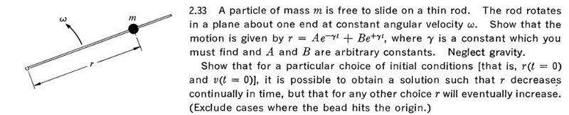

I do not why the particle does the simple harmonic motion. And how to find such innitial condition to satify r decreases continually in time.
3. The Attempt at a Solution [/b
Is it need to take derivative of r?

The equation given is NOT one of harmonic motion. It contains exponential non-periodic terms.
As for how to obtain the equation, recall the formula for acceleration in circular motion.
Is it a resistance force? If not, how can r decrease?
Before you can answer the question "how can r decrease", you must obtain the acceleration of the particle.
So it needs A+B<0?

Assuming γ>0 (which you can, without loss of generality), how do the individual terms e-γt and e+γt vary as t increases? How could you make a linear combination of them that always decreases?
I can get Be2γt>A

No, you need to find a linear combination of e+γt and e-γt, i.e. something of the form Ae+γt + Be-γt, which decreases (without going negative) as t increases. You have correctly worked out that e-γt does that. There's a very easy solution for A and B.

We may be at cross purposes here. In my posts I have A as the coefficient for the +γ term and B as that for the -γ term. Do you have it the other way around?
Anyway, what I'm trying to steer you to is that if A > 0 then Ae+γt will tend to +∞ as t→+∞, and completely dominate over the e-γt term, making it irrelevant (regardless of the value of B). Can you see that?
Conversely, if A < 0 then Ae+γt will tend to -∞ as t→+∞, again completely dominating the e-γt term, making it irrelevant.
So if you need the function to decrease as t→+∞ but without going negative, what does that leave as a possible value for A?

No, if A>0 then Ae+γt+Be-γt →+∞ as t→+∞, for all B. So we can absolutely rule out A>0.
Similarly, if A<0 then Ae+γt+Be-γt →-∞ as t→+∞, for all B. So we can absolutely rule out A<0.
What is left?

A equals to zero. Because r cannot be negative, so A cannot <0. Plus, B>0.
xiaozegu said:
A equals to zero.
Yes!
