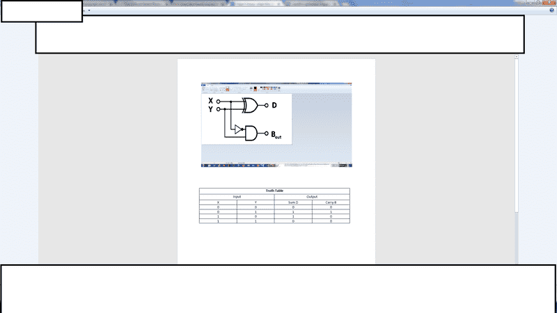

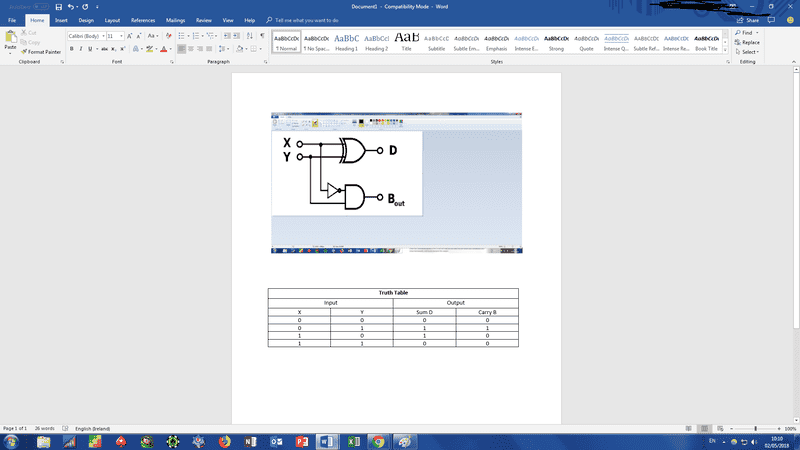

I have a homework question that asks me to draw up a truth table for the attached circuit.
As you can see I did this (I think correctly). There is also an attached question asking what function the circuit serves - I am not sure what function this is
Any pointers appreciated.

Hi jackill. :welcome:
Why did you call one output "sum" and the other "carry"?
Along the same lines as NascentOxygen's post, What do you think "D" and "B" could stand for?
Oops - I originally thought this was a half adder but later figured that wasn't correct. I forgot to change the boxes before I uploaded the image.
I guess there is a difference between what this circuit does, and what you thought the circuit did.
Hint: You weren't too far out of the ball park.

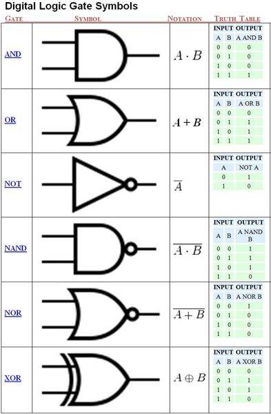

what your not seeing is an exclusive xnor gate
