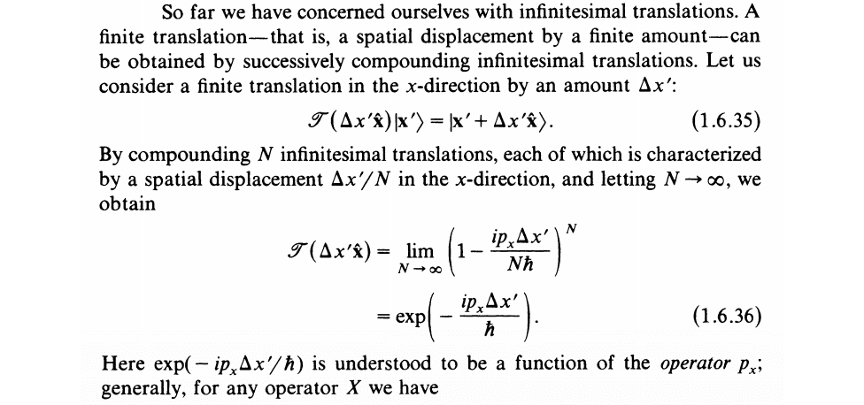

I don't understand about infinitesimal translation
and
But

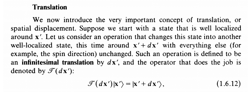

The infinitesimal translation denoted by equ 1.6.12 and 1.6.32
And then i understand about equation 1.6.35 but equation 1.6.36
Why they take limit N go to inf ? , multiply 1/ N ? and power N ?
So is the relationship below still true?
## F(Δ x'\hat{x}) = 1 - \frac{i p_x \dot{} Δ x'\hat{x} }{\bar{h}} = lim_{N → ∞} (1 - \frac{i p_x Δ x'}{N\bar{h}})^N ## ?
Likes etotheipi
If you want to displace a system by ##\Delta x##, you can do that in ##N## smaller steps of ##\frac{\Delta x}{N}##. Each of these steps is carried out by the operator that translates a state by ##\frac{\Delta x}{N}##. Carrying out one operation after another is represented by operator multiplication. So, in simple notation:
$$T(\Delta x) = T(\frac{\Delta x}{N})^N$$
You can then imagine taking the limit of this as ##N \rightarrow \infty##. And, in this case, looking at the form that ##T(\frac{\Delta x}{N})## takes, the limit is an exponential.
