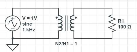

I'm looking to understand transformers as they apply to circuits only. I would prefer minimum background theory, but if necessary please include.
1. We know that a transformer splits a circuit into a primary and secondary circuit. So then, does the secondary coil act as a voltage source for the secondary circuit, or a current source for the secondary circuit? Does it depend on whether the primary circuit uses a voltage/current source as?
2. Following the equation ##V_2 = (N_2/N_1)V_1## , I'll assume the secondary coil acts as voltage source ##V_2##? Then hat is ##V_1##? Is that the voltage source of the primary circuit? There is no potential difference across the the primary coil (negligible resistance), as it is at a constant potential. Or does it have a potential difference due to the secondary coil? If it does, is this potential difference such that ##V_{1} = -V_{battery}##? Or else how does it work?
3. I don't really understand impedance in terms of transformers. The equation is ##Z_1 = (N_1/N_2)^2Z_2##. Does ##Z_1## actually exist, or is it just what it would be if we placed the component on the other side? How does that make sense? We learned that impedances depend on frequency only. On the other hand, if ##Z_1## actually exists, what if it is is a capacitor and ##Z_2## is an inductor?
I'm very confused.
Baluncore said:
This doesn't really help. Let me ask one thing at a time. If the amplitude of the voltage source is 1V. Is the amplitude of the voltage drop across the primary coil equal to -1V? In other words would this work?
Why -1V? Since the only load across the voltage source is the primary winding, you can say that the voltage across the winding is 1V.
Note that it would probably drop due to the load at the secondary side, so it would be somewhat less than 1V

So that its 1V + V_{winding} = 0. So that V_{winding} = -1V? I guess what I'm asking is if KVL applies to the primary loop.

For the primary winding I'm trying to see if it can act as something that offsets the voltage source in the primary loop. I'm trying to see if KVL would apply. For the secondary loop I'm trying to have it act like a voltage source that provides the correct current so that the voltage drop across the resistor is equal to it.
Well @rtareen it's good that you can derive those equations but you also need other knowledge as well.
Think about it this way. You are asking whether when one applies a 1v sine across a primary there is an opposite -1v sine across it. Why would there be ? A transformer is not a generator it doesn't produce power it just transforms it. If you apply a voltage of 1v across the primary then that's it there is just 1V across the primary and that's it. Now sure because a transformer is an inductive load the current will lag the voltage as within all inductors.
If you apply the same 1v across a resistor, or a diode or a capacitor you don't get an equal but opposite voltage across the element , then why would that happen in a transformer, try to explain it in your own thinking and words and if you can't then there is a reason for that...because that's not what happens.
You can ofcourse always perform a practical experiment and measure the voltage across a transformer primary that is connected to an AC source with a multimeter/voltmeter and then compare the measurement with the AC source, but I already told you what you will see.As for the secondary , please go and read the definitions of what is a voltage and what is a current source and then think about your question.
KVL, and KCL do apply separately for the primary circuit and the secondary circuit. But there is a mutual dependency in the two loops.
Rather than worrying about whether a source is voltage or current, study the math of the ideal transformer as others already recommended.

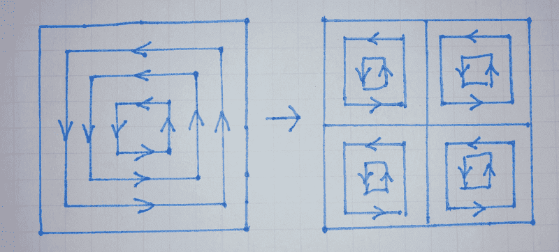

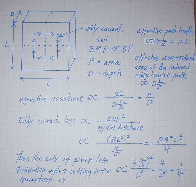

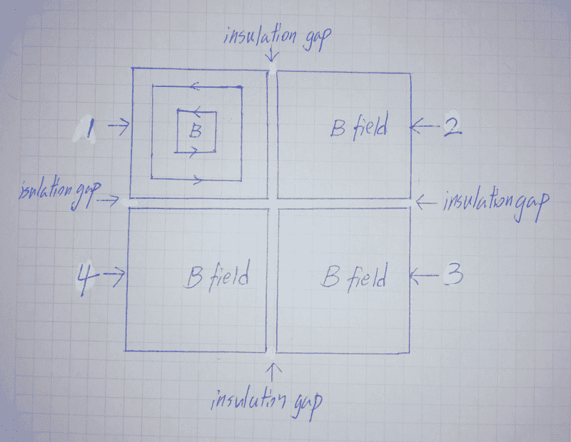

Notice in that link, how between adjacent laminae, the eddy currents counter flow, so cancel internally. But locally they are needed to get the field into the conductive magnetic material. The result after cancellation of internal sheet currents is the peripheral current that flowed without laminations.
Skin effect dictates the thickness of laminations. If you did not have sufficient gaps in the core material the magnetic field could not get in and out again before the field reversed.
It is the orientation of the laminations that reduces eddy current losses.
Likes anorlunda
  • #34
looks like we long since lost the OP :oldbiggrin:
  • #35
I think I see the eddy current problem slightly different than that of the link of post 32. Iron is a conductor and the Faraday EMF in the iron will cause significant current flow of the same symmetry (concentric with the core) as the Faraday EMF's that are generated by the coil windings (compare to a solenoid with an iron core). Laminations block this current flow in a capacitive manner=it only takes a little bit of charge to accumulate on the lamination to create a voltage opposing the Faraday EMF. The diagram of the link seems to mix the eddy current concept with the bound surface currents that are not blocked by the laminations. Basically the magnetic surface current per unit length ## K_m=M \times \hat{n}/\mu_o ##, with or without laminations. Perhaps I am missing something here, but that is my interpretation. (Note: Unlike the eddy currents, the magnetic surface current does not involve any charge transport).
and note, the paths the eddy currents take will be circular, (concentric with the center of the core), and laminations in a horizontal direction will be effective in blocking these circular paths. The neat thing is that the laminations don't block the magnetic surface currents, and the magnetic material (iron) behaves like it needs to=with laminations it is simply minus the eddy currents.
