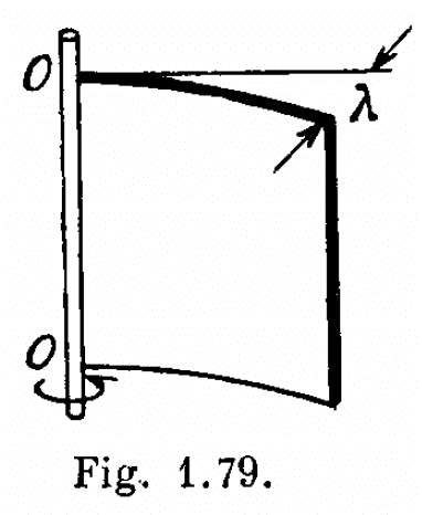

A steel plate of thickness h has the shape of a square whose side equals l, with h << l. The plate is rigidy fixed to a vertical axle OO which is rotated with a constant angular acceleration ##\beta##. Find the deflection ##\lambda##, assuming the sagging to be small

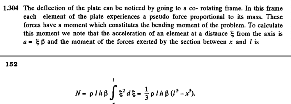

My struggle here comes from finding the bending moment ##N(x)##. My working is as follows.
We want to find the bending moment on an element a distance ##x## away from the axis of rotation. To do so, let us consider the bending moment due to the force on an element ##\xi>x## away from the axis of rotation. The perpendicular force on this element is ##\xi\beta dm##. Hence, the total bending moment on this element would be
$$N=\int_x^l(\xi-x)(\xi\beta \mu d\xi)$$
Where ##\mu=\rho l h## is the mass per unit length. However, the solutions manual has this expression
(Solutions to I.E. Irodov's Problems in General Physics, Volume 1, Second Edition, Singh)
Where the integrand is ##\xi^2##, rather than ##\xi(\xi-x)##. I initially thought that the solutions manual was wrong, but it seems like sources all over the internet have ##\xi^2## under the integral sign. Can someone explain to me what I did wrong?

A diagram would help. Is the plate in a horizontal or vertical plane? Where is the axle in relation to the plate?
I forgot to attach the given diagram, here it is (the axle is vertical, thus the plate is vertical)

Then I agree with your integral.
Yes I also agree with yourself and @haruspex. The bending moment ##N(x)## is applied to the element about a vertical axis passing through an arbitrary point on the cross section connecting the element and the rest of the square. The solution they give computes it about the axis OO, which doesn't make sense!
Likes Lnewqban
Just in case anyone's interested, there's another way you could look at the solution that makes it slightly less wrong (but still wrong).
The internal forces acting on the outer element are comprised of a shear force and a bending moment. The easiest way to solve it would be to, as you did, balance moments about the point ##x##, since then the shear force has no moment. However, we could also balance the moments on this element about the axis OO.
The bending moment is, as always, produced by a couple so its moment about the axis OO is exactly the same as that about a parallel axis through the point ##x## - which is what you get if you evaluate your integral. Except now we also need to account for the contribution of the shear force, at a distance ##x## from OO, which we can compute by balancing forces in the axial direction: $$F_s = \int_x^l \xi \beta dm = \int_x^l \xi \beta \rho h l d\xi = \frac{1}{2}\beta \rho h l (l^2 - x^2)$$ $$\tau_s = \frac{1}{2}x\beta \rho h l (l^2 - x^2)$$ You will see that if you do the integral you wrote down, this term ##\tau_s## will be the difference between it and the book answer.
