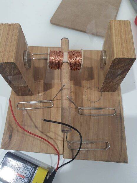

hi everyone, i need to build a dc motor for my school project. I have used copper wire for the turns (60 turns), wood to build the structure of the armature and commutator. i have used neodymium magnets as my permanent magnets and paper clips as the brushes. I tried using a 9v battery with a clip connector connecting with the brushes but my rotor does not seem to move. I know there is current passing through because the wires heat up but there is no force. I have sanded off the coating on the copper wire that is looped around the commutator but maybe i have to sand more off? could the hot glue i used to assemble my armature be an issue? do i need more turns? I'm really stressed about this and i would appreciate any suggestions on how i can get it to work. thank you!
here is a photo of my model:
There is no force at all on the rotor when energized? The rotor should be a single coil (all the same helicity) and the stator magnets arranged |NS|(rotor)|NS| .
Likes hi8192
yeah there is 0 force, i even tried giving it a kickstart to get it moving but it doesn't seem to work. I'm not sure what you mean by single coil but i have arranged the magnets as you've suggested.
I mean that the coil has the same helicity all the way across so one end is N and the other S until the electricity is commutated and it switches. The iron core is continuous for stronger magnet.
Likes hi8192
hi8192 said:
... , wood to build the structure of the armature and commutator. ...
What is the coil wound on? An iron or a wooden armature?
The coils look to be wound in the right sense, but I cannot see the cross-over between the coils.
Positively identify the poles of the magnets, mark them clearly with N and S.
Use a magnetic compass, or another magnet, to determine if current flows through the coil when you connect it.
Likes hutchphd and hi8192
What does that mean? Usually you would solder the two inner ends of the coils to the two pieces of the commutator, not try to make Ohmic contact between the inner ends of the coils and the commutator. Can you post pictures of the motor more disassembled so we can check it? Thanks.

That does that mean? Usually you would solder the two inner ends of the coils to the two pieces of the commutator, not try to make Ohmic contact between the inner ends of the coils and the commutator. Can you post pictures of the motor more disassembled so we can check it? Thanks.
the youtube video i was following said to sand off the enamel so i did lmao - i'll post the disassembled pictures in a few hours when i get home
hi8192 said:
i wound them around a wooden armature
There is your problem. An iron armature is needed.
I wound my first motor with button sewing thread, not copper wire.
oh i hadn't even thought about an iron armature - do u have any ideas how i would make/buy one?
I would use an iron bolt with the head at one end, and a nut at the other end to balance it.
Perhaps if you gave us a link to the YouTube video, we could do it their way.
Likes hi8192

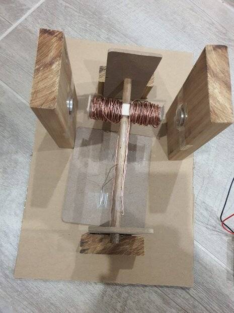

okay so i shortened my dowel and armature to reduce the mass, and used a thinner coil (0.4mm) for the turns (80), i also took your suggestion to use the pin bearings but the motor still isn't working. i'd appreciate any more suggestions you have. here's an updated pic:

Have you checked the orientation of your magnets ?
Use a magnetic compass or another magnet to sense the polarity.
You need to reduce the gap between the armature ends and the magnets.

the magnets are definitely attracted to each other - i tried determining the exact polarity using the phone compass but it didn't work (kept pointing to west) and i don't have a physical compass so i think ill borrow a magnet from school tomorrow and test it out. i did also reduce the gap but that just led to the magnets being pulled towards each other
there is a small force! when i give it a jump start, the commutator rotates a bit on its own but it won't continue. i'd upload a video but it won't let me
A video will NOT help diagnose the problem.
You need to get the magnets closer to the armature, even if you have to hold them down.
Does it spin by hand, or are the bearings not free to turn?
A small toy magnetic compass can be used to test the polarity of the magnets. If you remove the magnets, it can also be used to sense if current is flowing through the wire.
Likes hi8192
Good. I notice that the paperclip brushes are not exactly opposite (180 degrees). For smooth operation both the bushes and the commutator should be opposed by 180 (and offset as suggested). Also if you have extra magnets you could stack two at each stator.
Likes hi8192
i stuck the magnets closer to armature with hot glue and when i gave it a big enough force it actually spun for around 15 secs! I'm going to align the paperclips at 180 degrees as suggested, determine the polarity and hope that it continues to work otherwise i'll buy some more magnets to stack. thank you so much! I'm so relieved

I can't be sure from the photograph but is the wire you are using insulated? Sorry if this is telling my grandmother how to suck eggs but I have come across many failed motors that were wound with uninsulated wire. The wire I can see could be just copper or it could be enamelled with a coppery coloured enamel. Then the ends need to be well cleaned of enamel to make a good contact with the 'commutator.
