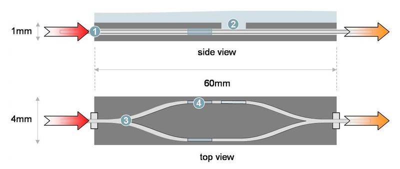

OK so sorry for my previous response but that is due to a previous experience. the scenario I am putting forward is some how different form a simple beam splitter, in that a beam splitter is essential a four port element, two input two out but and it is obvious if you write down the governing eqs that if beam interfere positively in one of the ports they will interferometer negatively in the other port. The element I am proposing is have three ports, that is two waveguides that evancently couple to a central wave guide(waveguide2) this device is then three port device. that is two waveguides 1 and 3 compeletly couple their light to the central one.
or you can also think of the image below( machzender interferometer). what happens if the two arms are 180 out of phase?
Actually this issue has taken me a lot of time I know the answer with the fact that if you have constructive interference here then you get destructive somewhere else but it really dose not apply here dose it?
Oh, I see. I am no expert in terms of waveguides, but here is the stuff I know. Any real implementation of such waveguide-based MZ-interferometers uses four-port directional couplers instead of three-port ones. The group of Jeremy O'Brien over at Bristol does that excessively for example (see e.g. "Manipulation of multiphoton entanglement in waveguide quantum circuits" by J. Matthews et al., Nature Photonics 3, 346 - 350 (2009)).
Now the question of course is why three-port devices are never used. Wikipedia is not really a good resource, but has the following to say about the topic: "These suffer from very poor isolation between the output ports – a large part of the power reflected back from port 2 finds it way into port 3. It can be shown that it is not theoretically possible to simultaneously match all three ports of a passive, lossless three-port and poor isolation is unavoidable." The following book is cited, but I do not have access to it and cannot say whether it includes an in-depth study of the problem: Antti V. Räisänen, Arto Lehto, Radio engineering for wireless communication and sensor applications, Artech House, 2003.
My guess is really that the problem is similar to the problem that creating an ideal three-port beamsplitter is not possible and the crosstalk between the output ports will automatically create a situation in which energy is conserved. However, I am not aware of any experimental or theoretical study of crosstalk properties of three-port directional couplers, but I am sure there must be some out there.
