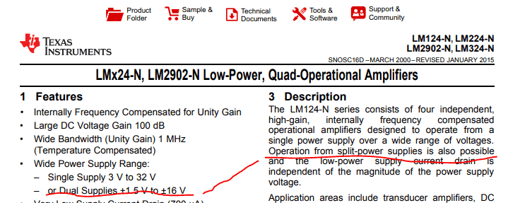

The 124/224/324 opamps work fine with a dual supply.
Connect a pair of 6 volt or 9 volt batteries in series
and declare their junction "ground".
Connect +6 (or +9) to amp's V+
and -6 (or -9) to V- to amp's V-
and their junction to circuit common.
245246
Likes sophiecentaur

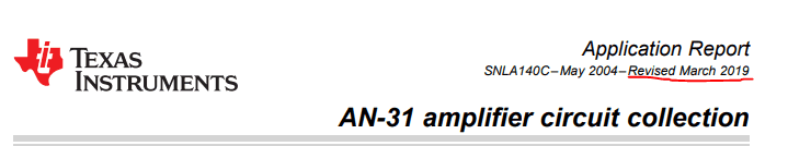

@David lopez
When starting out it is useful to study circuits that have already been designed and figure out why they work.
In my day National's AN31 was a handy reference for "How do i do something" type questions.
The guys at National didn't show power supply connections to their circuits because they assumed anybody reading would be experienced enough to know about single vs dual supplies, common mode voltage, etc.
To my surprise the National engineers wrote an article saying they got a lot of questions from people who built a circuit but did not power it at all because the schematic didn't show any power connections.
Wow !
I notice AN31 is still around but it's now a TI document (TI bought National some years back).
The questions must have persisted because they now show power supply connections in their sample circuits.
Here's a link - have fun !
http://www.ti.com/lit/an/snla140c/snla140c.pdf
Wow i see it was updated just this March ! I was reading it forty plus years ago !
Must be a good teaching tool to have survived all thee years.

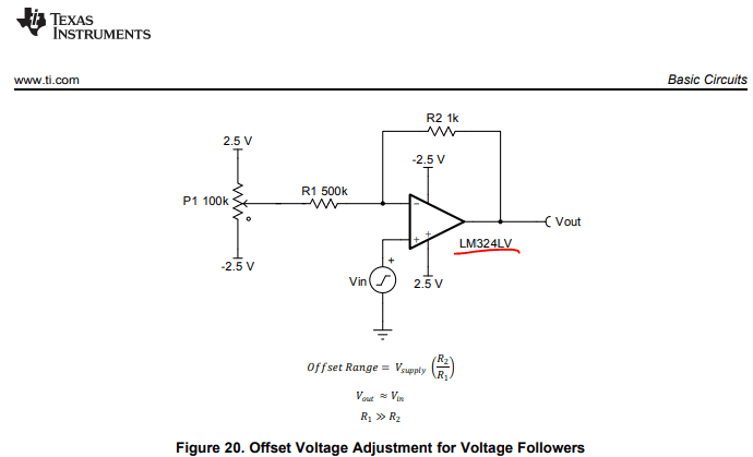

245287
a few pages in is 124 series with split supply.
245288
Practice writing transfer function equations for the circuits.
Write KVL for both inputs, set them equal and solve for Vout/Vin.
Soon enough they'll become intuitive.
