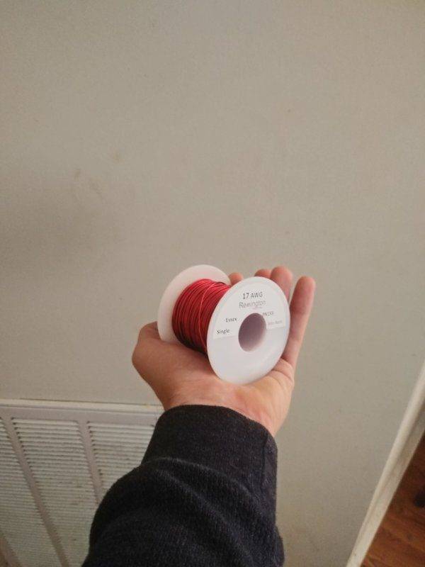

This is the wire not coiled around the aluminum tube.

BTW, have you considered multi-layer wound coil design on your coil form?
zoki85 said:
Why not?
Seems you are avoiding presence of the iron at any cost...
The coil is multi layer, that is my mistake for not specifying

But my point is why not to make a multi-layer coil using all 507' of AWG 17 wire and more batteries in PSU
Oh wow, I did not mean to type 507. 157 is all I've got and it is wraped over a three inch length of tube. I could add more batteries but it already seems like the coils are getting very hot without really making that strong of a field.

Wow this really helps a lot. I should clarify that the object attracted to the magnet is passing through the center of the coils, so yes, I could surround the coil in iron to contain the field. What is the field strenght of the coil measured in? Tesla? Also I'm am struggling with which gauge of wire to select as I all really know is the voltage of the battery I have.
  • #35
NathanSM said:
I meant "I want to learn how to determine what gauge I need" Does this mean I could use any combination of length/gauge that would reach 100 ohms?
That would be a minimum and it is more to stop the coil getting too hot because of high current flow
and draining the battery(s)
NathanSM said:
How do I figure out how many ohms are required?
The Ohms required isn't your main requirement
In post #33, @Tom.G gave you the main requirements
The field strength of a solenoid is proportional to (N×I)2, where
N is the number of turns
I is the current in Amps.
the physics of the coil will already contain the magnetic field reasonably well ( sort of)
putting the coil in a metal box isn't going to help concentrate the magnetic field.Only an iron core will do that
absolutely tiny ... microTesla or less
