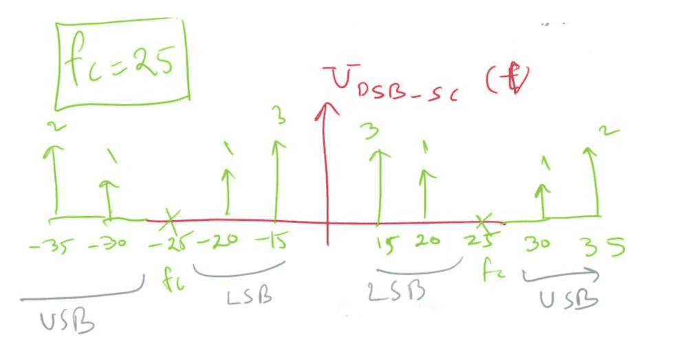

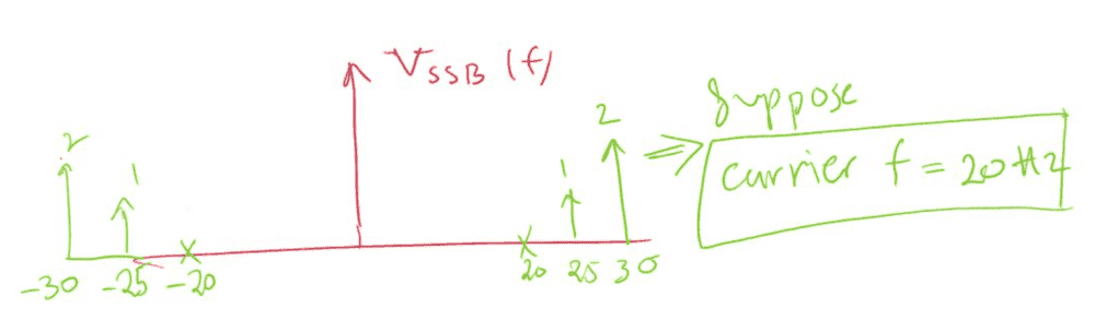

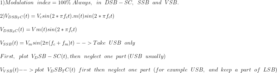

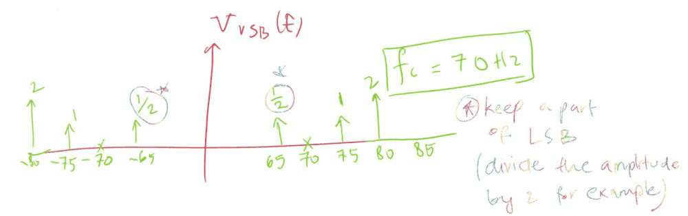

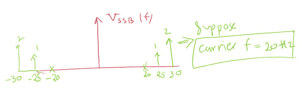

I have some doubts regarding AM Modulation. Here's what I understood, could someone please what I wrote below?
3) Suppose, V DSB-SC as follows:
Are the following spectrums correct? The carrier frequencies are given as an example.

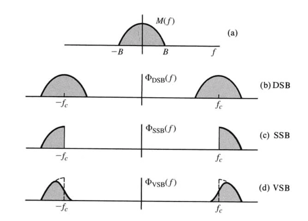

The SSB and DSB-SC spectra look correct to me. I wasn't too familiar with VSB, but a quick google led to these lecture notes from Stanford (here). There is an image (shown below) in the notes which supports your understanding of VSB, so I think you are correct.
(I think the DSB may be DSB-SC as I cannot clearly see the carrier peak shown)
Hope that is of some help
