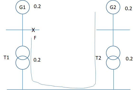

Your diagram for part b on the top of page 4 is not quite correct. The way I redrew it, the generators and transformers are not it parallel.
I put an X to indicate the fault. So G1 feeds the fault only limited by its own impedance. G2 feeds the fault but includes T1 and T2 impedances in addition to its own.
So mine is not in parallel.

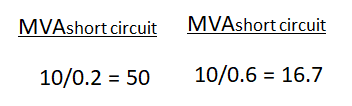

For part b, I am going to trace out the path to the fault from G2 since it is more involved. The path from G1 to F simply involves a pu impedance of 0.2. The path from G2 involves G2, T2 and T1 as shown below.
Here are the pu impedance for each path:
The resulting short circuit MVA is the base MVA divided by the pu impedance, or
So there is a total short circuit MVA of 66.7.
Now, to apply what I learned from your attachment, base "voltage" MVA for the path from G1 is simply 10 MVA across a 0.2 pu impedance.
For the path from G2 to the fault, the resulting 10 MVA will have 3 equal parts, each 0.33 pu.To your discussion, I agree you would have to have one generator picking up the entire load and then have to synchronize the other one before closing it in.
