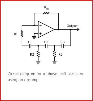

I have tried building a phase shift oscillator, but it won't work
In summary: A breadboard with two positive rails and two negative rails can support up to 4 power supply voltages plus ground.
What power supply rails are you using with the opamp? Which opamp is it? Do you have an oscilloscope to use for debugging?
If you do have an oscilloscope, draw the circuit diagram with the pin numbers shown on the opamp, and use the oscilloscope to probe each of the nodes in the circuit. Write down the DC voltage that you find at each node, and scan and attach that drawing to a reply here. That will help us a lot to guide you to get the circuit working.
What is your target oscillation frequency, BTW?

That circuit would appear to want to oscillate around ground (given the biasing), so you will need split supply voltages to give the opamp compliance with the power supply rails. Maybe for an experiment, try two 9V batteries hooked in series to give you +/- 9V power supplies to the opamp.
You also did not say yet which opamp you are using, or what component values you chose for what oscillation frequency. Did you build this on a plug-in type breadboard?

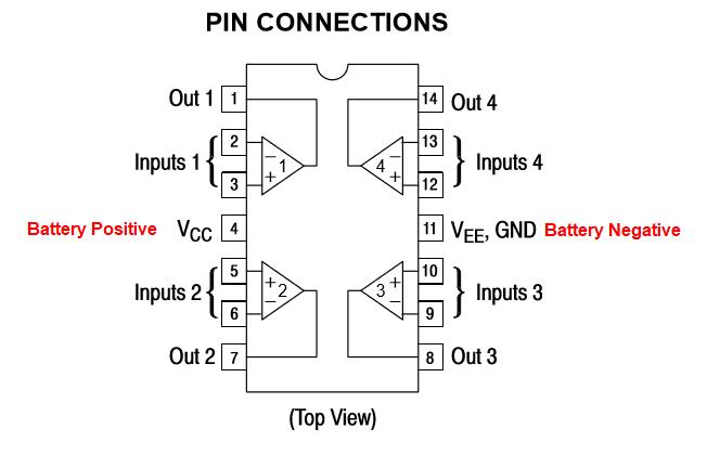

I am using a lm244 operational amplifier. I made sure the ground pin
Was connected to the negative terminal. I made sure the voltage supply pin was connected to the Positive terminal. The 18650 lithium ion cell I use have a measured voltage of 4.2 volts roughly. I use a single supply configuration. Each resistor has a value of one kilohm. C1 is 120 μf, c2 is 120 μf, c3 is 6.8 μf.
Hopefully not the + and - terminals as shown in those circuits
They are not the power supply pins
the chip datasheet shows the power connections

That was a typo. I am using the lm224.
And I have the datasheet. I use the datasheet to make sure the wiring is
Correct.

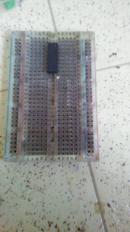

Do You need two positive rails and two
Negative rails to provide split power
Supplies? I have a breadboard with two positive rails and two negative rails.
What does that mean? Can you post a picture? Does it mean that the breadboard you have can support up to 4 power supply voltages plus ground?

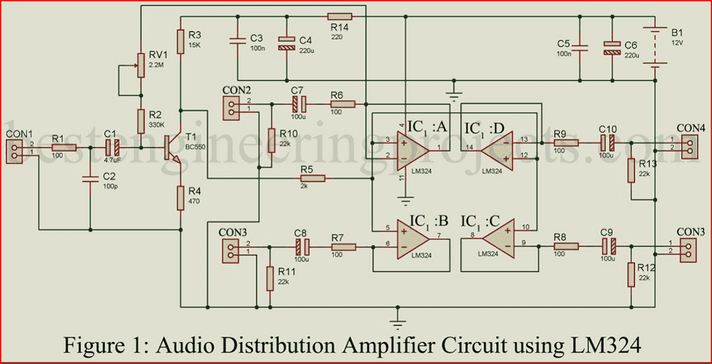

You should connect your split +/- 9V power supply voltages to the +/- power input pins of the LM324/whatever. If you were using all 4 opamps in the package, it would look something like this (this is not an oscillator circuit, and you should connect -9V to the IC pin 11 instead of the ground shown in this schematic):
https://bestengineeringprojects.com...istribution-Amplifier-Circuit-using-LM324.jpg
244993
When you use only one opamp out of a quad IC package, it is best practice to tie the other 3 opamps off in a way that minimizes noise and power consumption. You can connect them as followers with ground at their + inputs, for example.

This breadboard can support two
Different voltages.

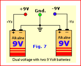

Do you connect the negative terminal of one battery to the Positive
Terminal of the other battery to make a split power supply?
Ah, yes. Assuming that each of those outside 4 columns are connected vertically, I usually will use the inside two for ground connections (and tie those two columns together at one end), and use the outside two columns for my +/- supply voltages. If I need to support +5V and also +/-12V in the same circuit, then I only get one ground column.
Here is how you connect two 9V batteries to give the split supplies that you need for your oscillator circuit:
https://forum.allaboutcircuits.com/threads/make-create-dual-power-supply-from-two-single-power-supplies.146835/
245000
So you connect the Positive terminal
From battery a to ground and connect
The negative terminal from battery b to the same. Ground
