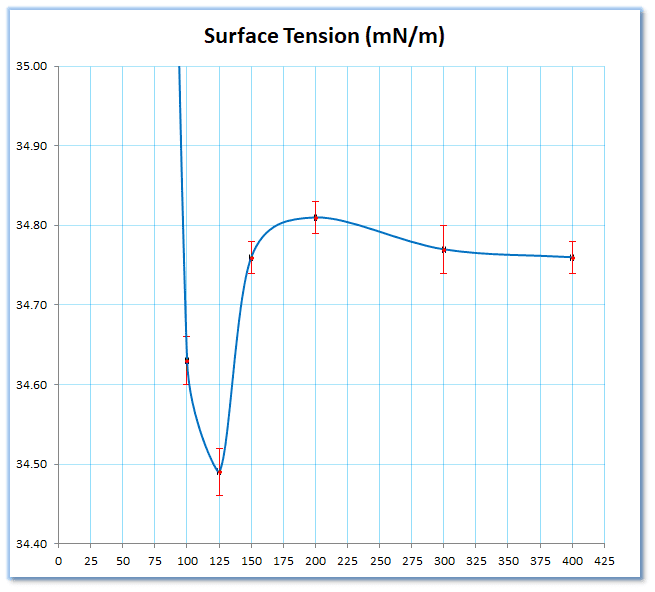

I just wanted to know how to find errors/uncertainties from the graph. You can see the graph, I want to find the uncertainties at 175 ppm where I have not measured at 175 ppm. so, if I want to know the error for the particular value. what predication/equation should I use?

The information available is not sufficient to conclude an uncertainty. You will have to make a separate consideration to estimate that, I'm afraid.

So, In this graph, I have taken my measurements at different concentrations. So, I have taken at 25 ppm to 400 ppm. I have the value and the error/uncertainty for the exact concentration (i.e. 25,50,75,100,125,150,200,300,400 ppm) but suppose I want to find/predict the uncertainty of the point (i.e. 175 ppm) where I have not measured. So, Is there any equation should I use to find the error?
What exactly is the plot a graph of? You didn't label the axes, so it's not clear.
The short answer is "it depends" How did you assign the error bars on the graph?
If you have no measured point, you have no uncertainty on the measurement.

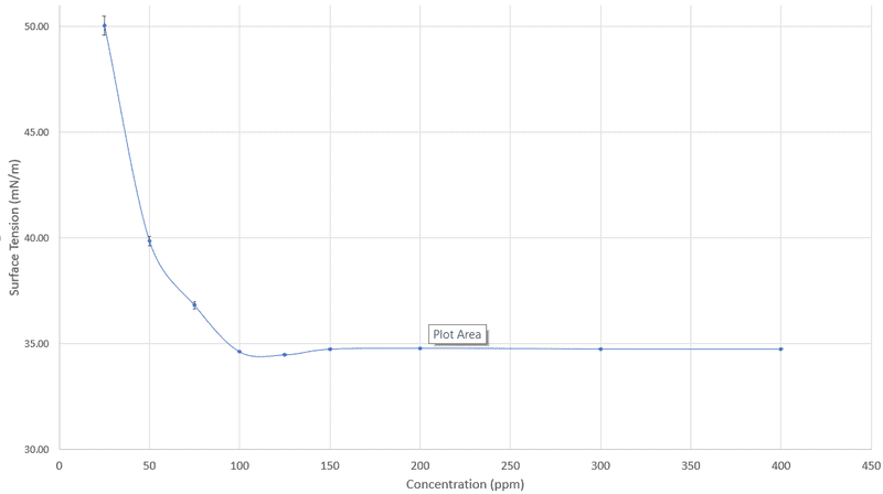

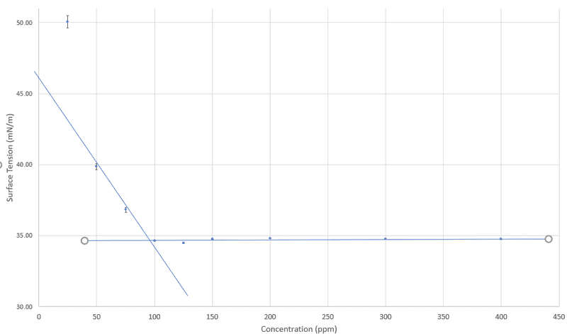

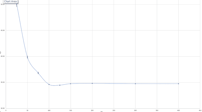

I have attached the graphs here for the same data. I can use the data both ways using tread lines.

So now, can I find the uncertainties or errors of where two straight lines (trendlines) touch (around 90 ppm)?

Concentration (ppm)Surface Tension (mN/m)Errors/Uncertainties (mN/m)
25​
50.06​
0.45​
50​
39.86​
0.22​
75​
36.83​
0.17​
100​
34.63​
0.03​
125​
34.49​
0.03​
150​
34.76​
0.02​
200​
34.81​
0.02​
300​
34.77​
0.03​
400​
34.76​
0.02​
Here I attached the measurements and errors for the measured values but I have not measured at the 175 ppm. so, how one may find errors for the unmeasured point?

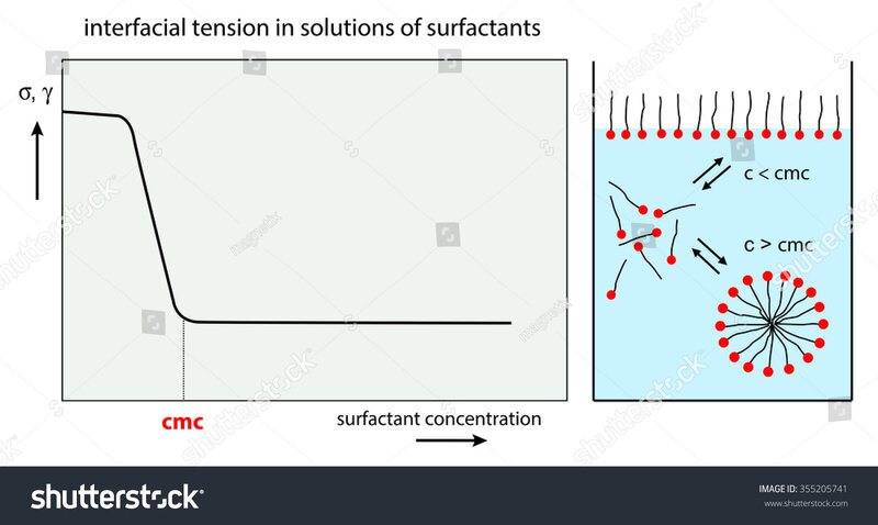

I do not see any pattern here but usually, in an interfacial tension graph, it starts with decreasing and then remains stable.
hutchphd said:
What is the fitted curve in the graph? Is there an expected shape?

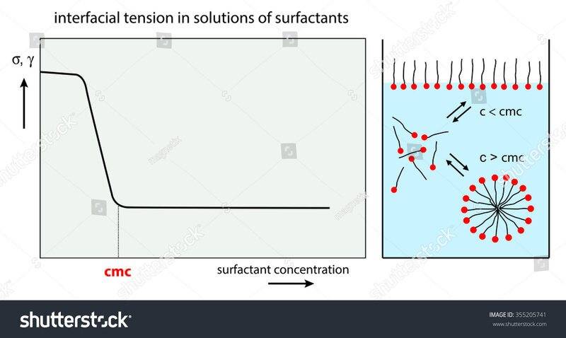

You can refer to this image.

In the absence of a theoretical model for how the transition occurs, it is not possible to interpolate a value. Judging from the image in post #17, a theoretical model should be feasible, but it might be quite complicated, involving the statistics of energy distribution.
That said, spline fitting is commonly used in engineering. Years ago I saw a paper that made a good case for gluing together arcsin(x) curves, but I forget the details. This paper uses "biarcs": https://core.ac.uk/download/pdf/81993903.pdf.

The occurrence of a significant dip at 125 ppm worries me no end. Is it a genuine theoretical possibility or an artefact ?
What is the time history of the measurements ? Are the individual measurements really independent (do you prepare fresh solutions in a new container from scratch for each new point?), or can there be some time lag ? If the measurement series are in sequence from low to high ppm, can there be an undershoot after the steep decline from 75 to 100 ?
Idem the overshoot at 200 ?
Is it possible to check the 60 measurements of individual points to see if they are really normally distributed in time, or possibly show some systematic drift ?
For 60 points (normally distributed) the standard deviation estimate has some 12% accuracy. It is strange that the last six points have 0.02 or 0.03 . Instrumental limit to two decimal places ?
Would going backwards from 425 to 0 (or 25) ppm produce the exact same result ?
Why the specific interest in the 175 ppm point ?
Lots of considerations possible. A real experimentational challenge :smile:
Without further detailed information it is impossible to distinguish between 34.80, 34.78 or 34.76, all ##\pm##0.02 , for 175 ppm
